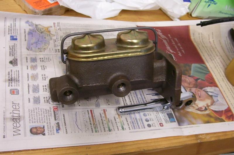

one of these will work for manual drums.
