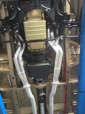

Stock Mopar mini starter on my 526 too. 100% satisfaction.
