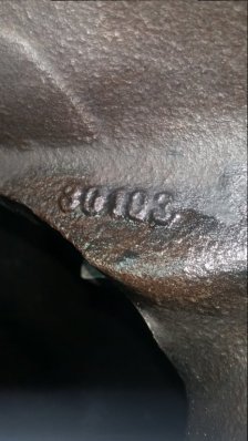

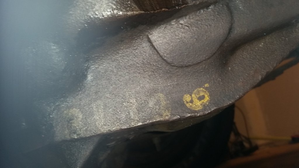

I have a 1973 charger see 400 bb 2bbl auto. I was cleaning it to get the numbers off of it to see actually what I had. Does any one know to look up these numbers and tell. The only one I read if there's a 9 painted on it it's a 489 that's all I've found and read on.

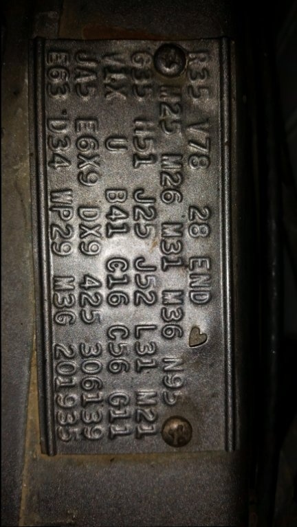

If the car was built at the Lynch road plant (A in the VIN), then the axle assembly is listed on the tag. Post a picture of the tag and we can tell you exactly what came in the car when built.
If the car was built at the St. Louis plant (G in the VIN), then you will need to find the broadcast sheet to find the same axle assembly code. If you have the broadcast sheet, post a picture of that.
If it's a 489 case, we know it's an 8.75 axle. What we cannot tell by a picture of the back is what gears came with the car.
If it's a 489 case, we know it's an 8.75 axle. Whate we cannot tell by a picture of the back is what gears came with the car.
if you know all that...spin the wheel and watch driveshaft rotation...one full rotation of the driveshaft...count how many times the rear wheel revolves....divide by 2 if non suregrip

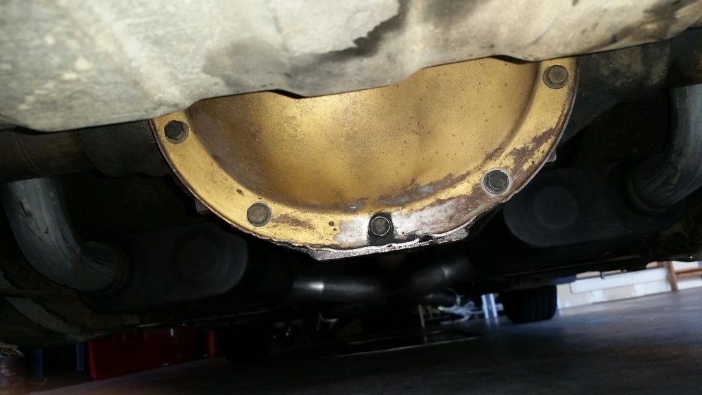

73 Charger 400 2bbl will almost certainly be an 8.25 from factory. As mentioned before, the broadcast sheet will give all the info, or a picture.
IF it's a 489 case, then it's an 8.75 rear end.
IF he wanted to know what rear end he had, then the question was answered.
IF he wants to know what gears he has, then a picture of the rear is useless.
8.25" rear end, and if you remove the cover, the gear ratio is usually stamped into the outside edge of the ring gear. It will be the pinion teeth and ring teeth, then you do the math.
I just had a new gasket put on in CA when I purchased the car. I'm not going to take it off at this time.
Then, push the car forward (or backward) one revolution of the rear wheels, and count how many revolutions the driveshaft makes. You can get pretty close this way.
