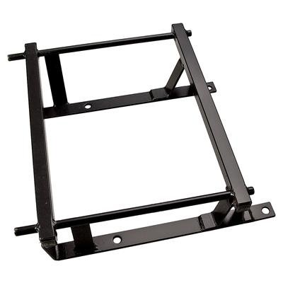

I had about $700 in the 2 seats & brackets when I purchased them in 2011 IIRC
from Summit or Jegs, I can't remember which
68 RR #18 Apr 26 2011 #1.JPG Pro Car-Scat Elite 1100 #51 demensions sketch.gif Pro Car Seat Adapdter Brackets Driver side SCA-81342 $77.95 Dodge Plymouth.jpg Pro Car-Scat Elite 1100 #51.jpg

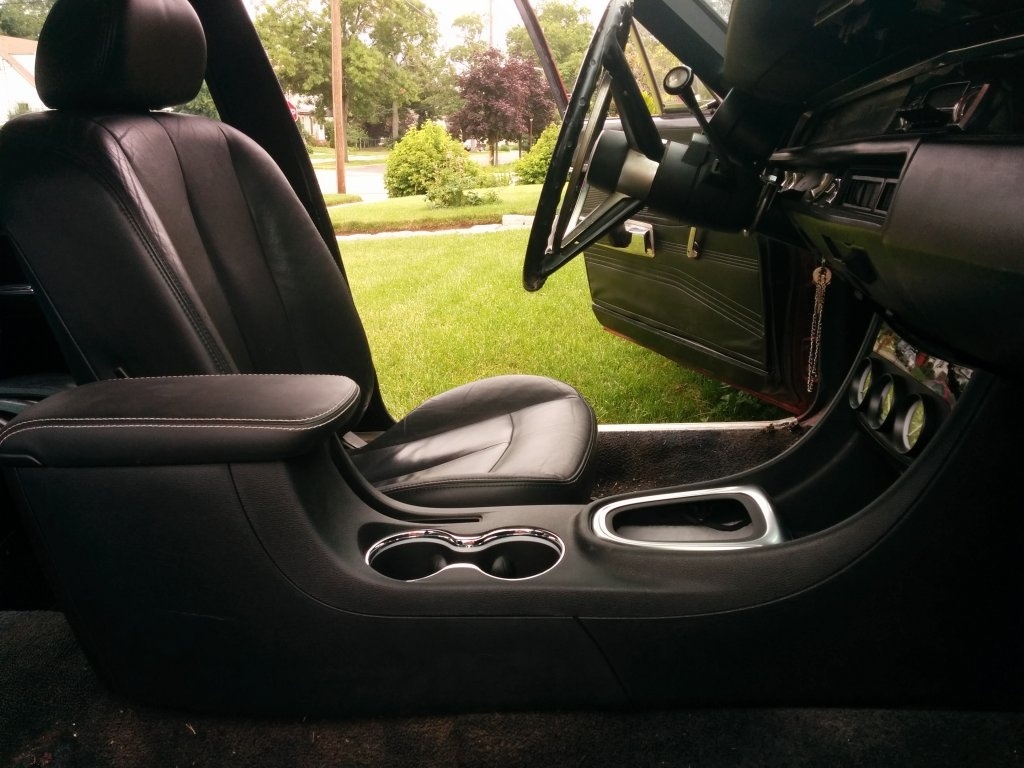

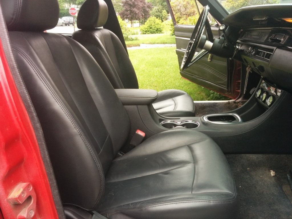

My 68 Coronet Wagon got 2003 Nissan Altima seats, D/S power and heat with a 2014 Chrysler 200 center console. It was amazing how little work it was to fit everything. Used the Altima frames too.
What people need to remember is that is you use seats out of a 4 door car, they will NOT recline forward much for rear seat access. My SRT4 seats do, but lucky for me the seats also slide forward plenty. There is room for robust people to get to the rear seat, though I've never had anyone big back there except a 220 lb friend.
