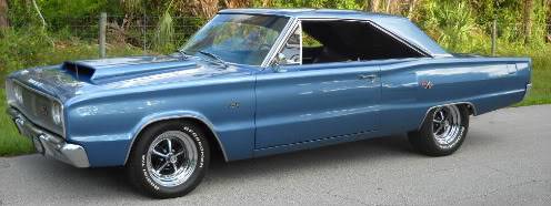

I have a 67 coronet R/T and I have 15x8 with 275/60/15's on the rear with 4.5 backspacing and 15x7 with 225/60/15's on the front with 4.25 backspacing I know that setup will fit on a 68
here a pic to see what they look like

I have a 67 coronet R/T and I have 15x8 with 275/60/15's on the rear with 4.5 backspacing and 15x7 with 225/60/15's on the front with 3.75 backspacing I know that setup will fit on a 68
Looks great, I agree, :iamwithstupid: Those are both good #'s for rims back off set, for 15x7's & 15x8's... on a 68 Coronet R/T you can go even wider on the rims & tires especially in the rear, 15x9 w/5" B/S & 295/50/15's will easily fit, with no rubbing issues anywhere... I have 245/60/15's front & 295/50/15's rear on a 68 RR with no rubbing isssues & the wheel wells are just slightly larger on the 68 Coronets, "I think"... Also there is a great tire/wheel fitment tool from PERCEY for about $70 from Summit Racing, it's well worth the minor expense/investment to make sure to get the proper height, width, fit & look, for your specific ride height & suspension...
