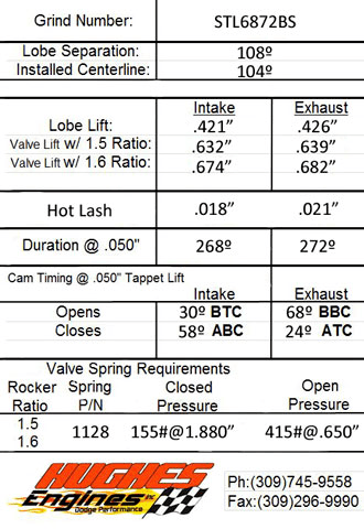

Sorry Tex I missed where you already were. You will be very close just by adding the cubes to 505. All my friends as well as myself gained .2 w/the same combo and simply adding the stroker. Some will argue against this but that has been our results.
I have had very good luck w/Hughes cams. In my Cuda at 3500lbs went 10teens at 129mph shifting at 6300. My heads were a little better(Indy SR's cnc'd by modern cylinder head to max wedge size). I ran this cam:
Anyways you are close and should hit your goal pretty easy. Look at Mike Gaines 505 and you can see how well he is running.

I can get a similar cam cut here in Australia . 268/272@050,.603/.612gross lift .012 lash , 310/310 advertised duration ,108LS,106 ICL . Not sure there will be much difference to the Hughes , may have a slightly higher peak rpm . I think i am starting to step back a little from my initial thoughts .

I think you may know my cam already Tex. Its a Dwayne Porter grind as I wanted to make some power and have a good sounding idle but be able to live with it on the street. Dwayne made mine 264 & 270 @ .050 with .585 and .592 lift. Its on a 110 LSA and I run it on a 106 installed centerline. It idles just how I like and works good for my 10.6 comp EZ headed 493. I just wanted to be able to drive to the track and run high 10's and drive home without touching the eng and it met my goal with no trouble. Course it has run 10.70's in street trim through the full exh on pump gas and I see no reason it could not be an easy 10.50 race car if I made it a race only car and took the exh off and went to skinny front tires with an electric waterpump and a Dominator. But it will stay a street car. Course one day I may try more carb then my 850 DP. Ron
