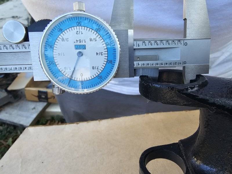

Post diameter of the u-joint cups if you have them. Some is odd. As said driveshaft should have 1330 u j cup dia 1.o625 outside clips. 7260 cups are 1.078 dia.

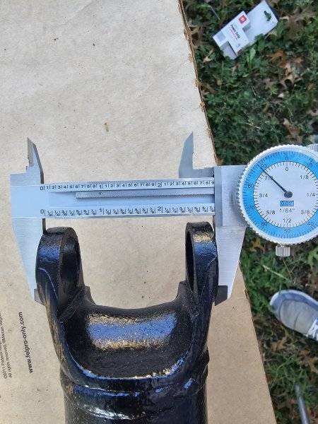

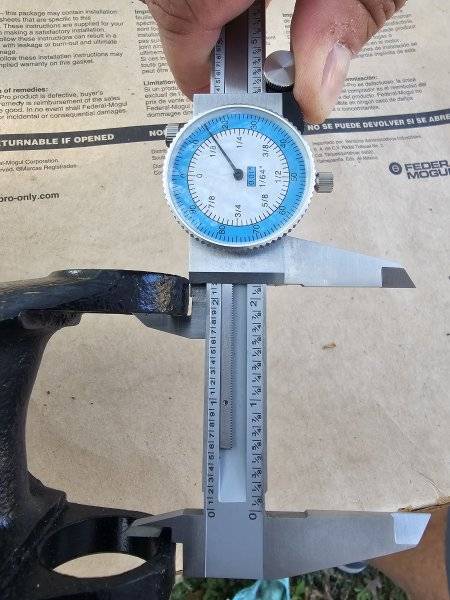

No remains of old UJs. I chucked'em. Here are the measurements for the end of driveshaft. The length of the driveshaft is just over 51''.20240910_175246.jpg20240910_175235.jpg20240910_125633.jpg20240910_175142.jpg

Better measure the yoke on the 8 3/4. Are you sure it’s an 8 3/4?
Remove paint from inside of holes for cups will make install easier. Your 7260 u=j should com with inside clips. Driveshaft looks machined for them, remove the paint it wil install easier.
