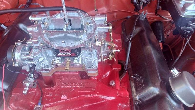

Hi Folks,
I have a 73 Duster, 4 speed I just slammed a 383 in. All I have is the throttle cable poking out the firewall. I need to know what bracketry/kit I would need to purchase?
Running a stock 4bbl manifold and a Edelbrock AVS, 650 CFM. Cheers.

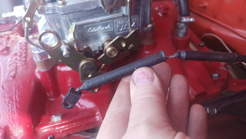

Every manifold change I do on my A body BB takes a different bracket. I start with an original cable clamp/hold down and make my own. Function over form, I guess.

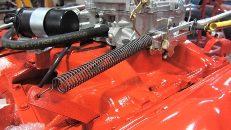

You'll need a throttle cable bracket, the stud and Edelbrock adapter that turbine68rt linked to, a throttle return spring and a return spring bracket if you don't already have one. This is set up for a 727 so it has KD linkage, but the rest of it is more or less the same.
