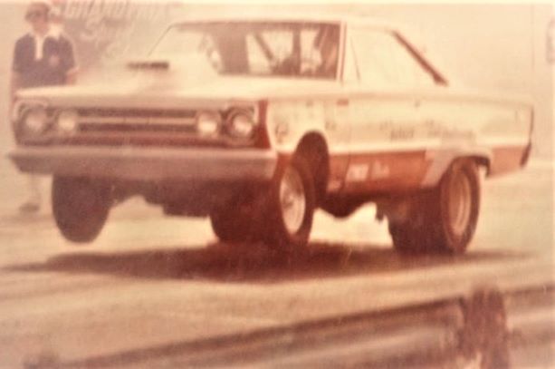

change it the very next time you blow the 8 3/4 , we started blowing one very weekend back in my hemi days , after the third one we went dana 60 and never looked back .
