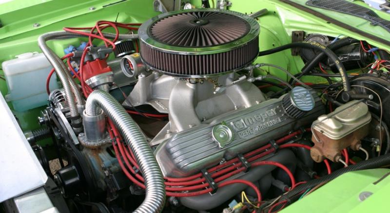

Just wondering what type of spark plug looms you guys are running on your engine with headers. I really like these ones but not sure who makes them image.jpg

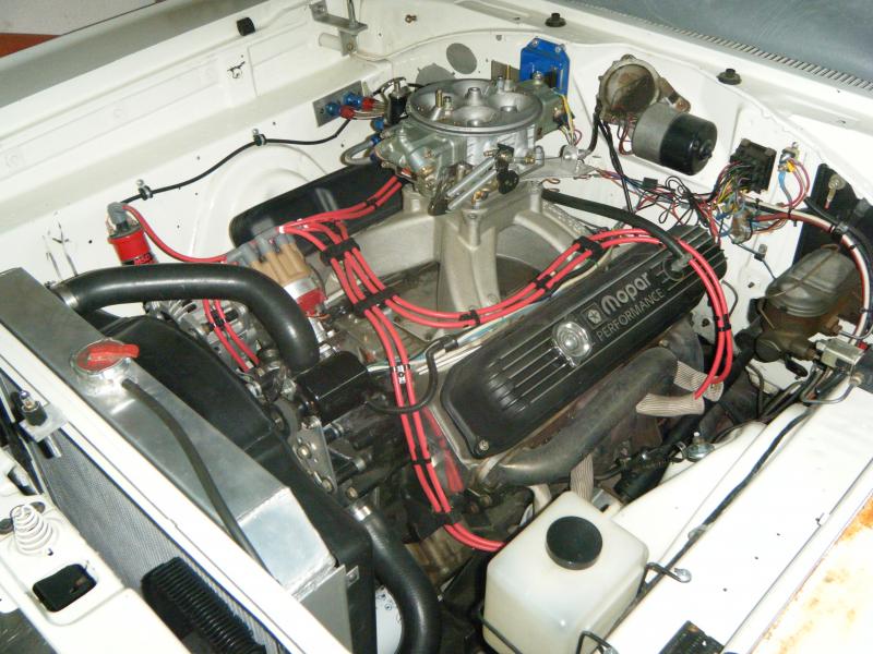

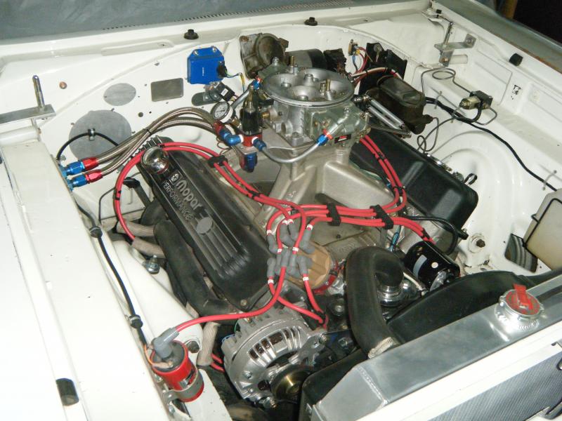

On big blocks I run them under the header and come in from the bottom. No looms needed. Keep them zip tied away from the header. You can't see them. Doug
