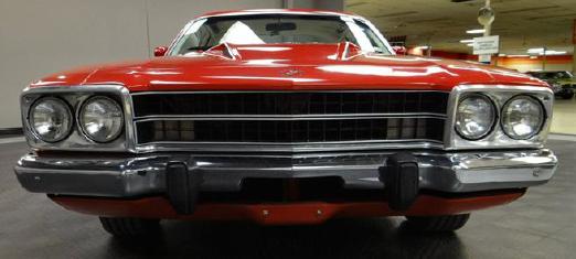

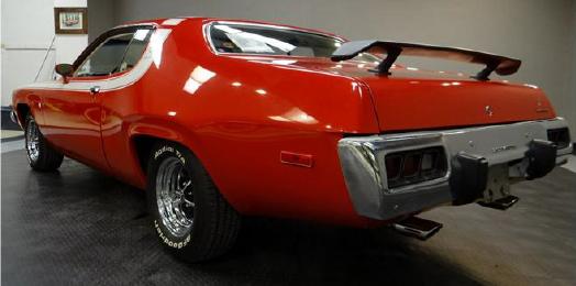

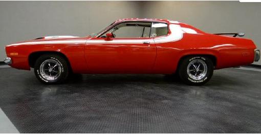

Hi, just picked up a "73 RR. side.JPGfront.JPGrear.JPG Not too bad a looker...although it came from 2000 ft alt. and came up to 6200 ft alt. It needs carb work for the non air up here around Denver but...it has a Summit Racing carb on it. Can anyone tell me what is the original carb for a 1973 RR 400 ci 260 hp stock motor? This car has a 4 speed manual trans but I don't know what gears are in it yet.
