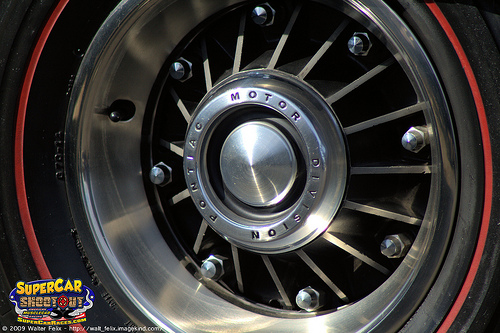

One of my older buddies had a 62 Grand Prix with a 389 tri power / 4 spd back in the mid 60's and it had the 8 lug wheels. The Pontiac 8 lug wheel was basically a huge aluminum finned drum / hub assembly with a cast iron liner where the shoes go - great looking setup by the way. The rim had no center per say and bolted to the edge of the drum with 8 lugs. According to the guy that put in the seat time in that car he said it slowed him down from 130 MPH without problems. Here's a pic of the wheel.
