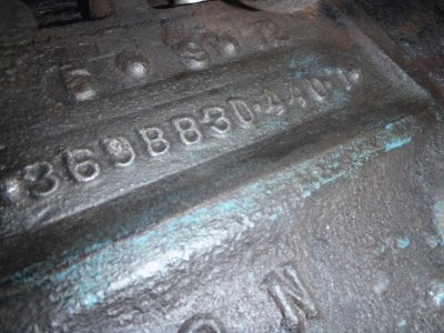

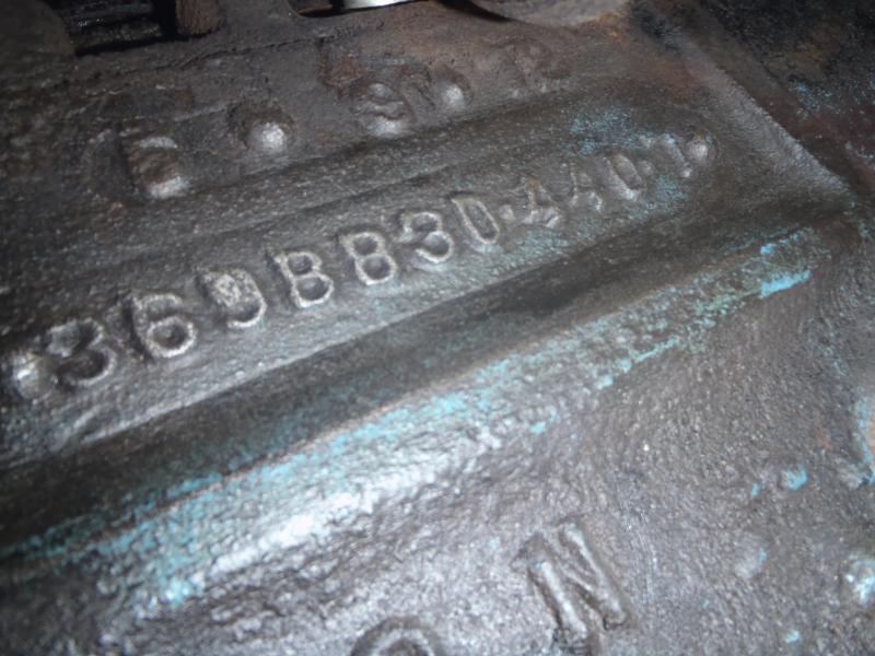

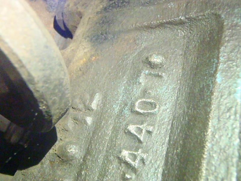

I P5040581.jpgP5040586.jpgm researching the same casting number this morning in my 1972 GTX. My casting number is also 3698830440 then followed by an I or and L. Mine also has what appears to be 72 stamped right above the main casting.

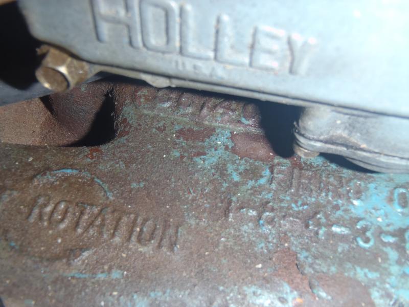

The 3698830440 motor has what appears to be the original 4 barrel intake casting # 3614014 so it's starting to look like my 1972 GTX might have the original motor. It looks like it's never been taken apart and possibly never removed form the car. Please let me know it there are any other numbers that I can look for the verify.
could the blue paint that's left on the intake be the original paint?
