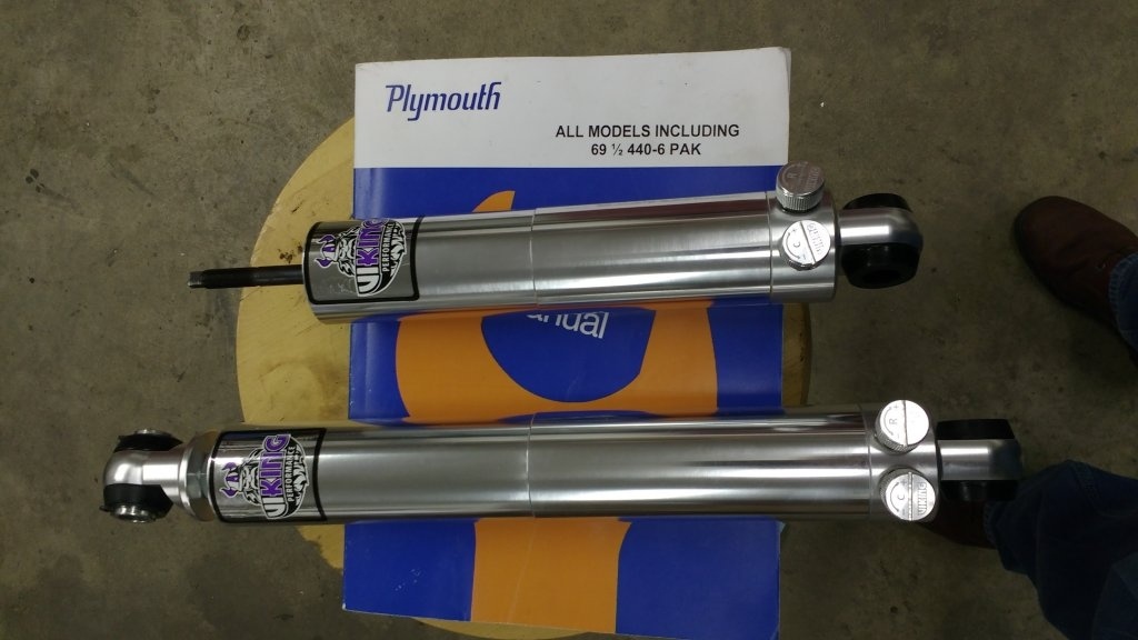

Just got off the phone with Jake from Viking shocks. He found me a front shock that has a little longer stroke and a little shorter compressed length. Should be just right for what I want. James at PST hooked me up. Love this group!
Just ordered my double adjustable shocks from PST. James put me in contact with Jake at Viking. Told him I wanted 5" of lift and it setting 2" lower than stock up front. Also springs moved in 1" in back and 1.5 lower than stock in back. He set me up with B202 (new version) for the front & B217 for the rear. $611 to my door. Can't wait! The new version has .75 more travel at the shock and a 1" shorter compressed length.
Received my shocks last night. Cant wait to get them on! Thanks PST
