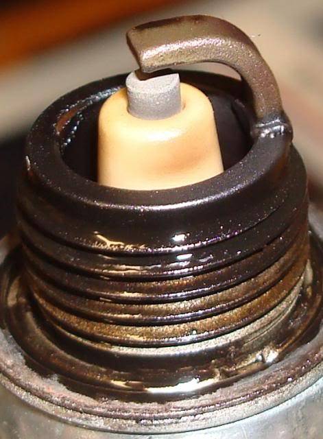

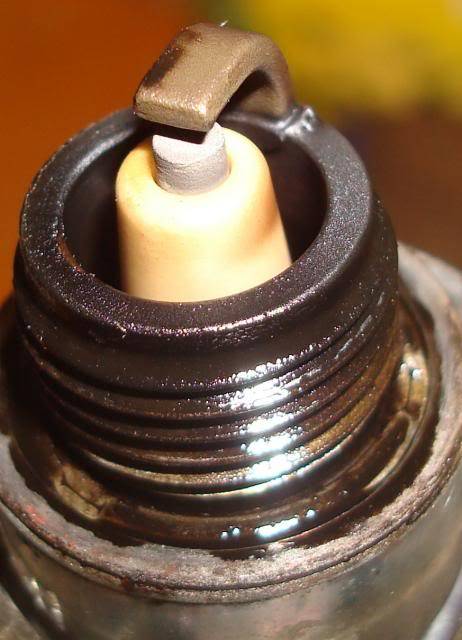

I've been having plug fouling issues of late when idling for long periods of time. It became really noticeable during the recent Beach cruises, where cars clogged the streets, and traffic came to a standstill.
Currently using NGK BP5S plugs, and I have had most success with those over the years. But i wondered if a hotter plug would help me cure the fouling without hurting the engine at higher constant RPM's.....any thoughts? :thinker: The A/F ratio was checked recently and found to be around 13.5-14.5 at idle and through the RPM range on a QuickFuel 780 V/Sec
Specs; 95 Octane gas, 10:1 compression, Edelbrock dual plane 2191, TTI 1-7/8" headers, timing spot on, MSD Blaster II coil, 8mm leads, operating at sea level.
Couple of pics of No.8 plug;
The fouling cleared after about 15 miles at 50-60mph, and of course hitting the higher numbers on the flat roads cleared the remaining carbon buildup. :headbang:

Those plugs look wet/oily, is this a well used engine?
No, engine is fine...this was No.8 plug, and the valve cover gasket has a tiny leak above. :head_smack:
