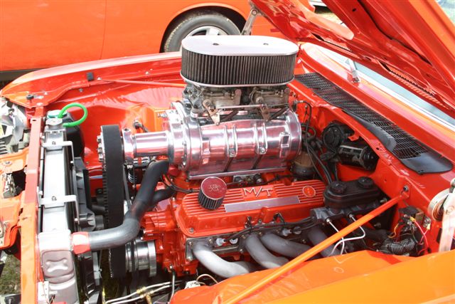

Looks like a similar grind that I run in my blown small block Volare. With a 6V-71, 340, home ported iron heads, 3875 lbs it runs 11.0@123 in street trim with mufflers.
DougView attachment 286164

Not sure about the duration & power brakes, but you can always run a vacuum reservoir tank if there's an issue.
