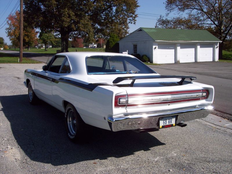

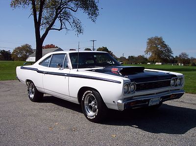

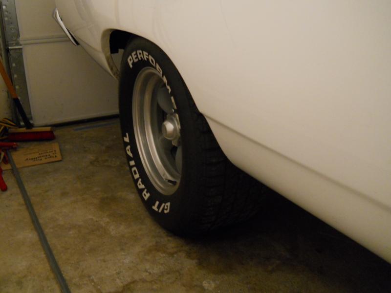

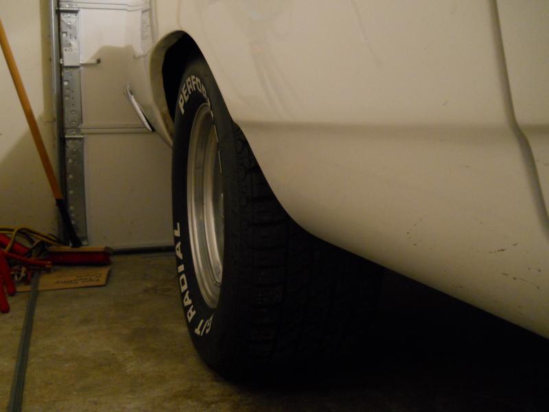

Here you go. They are American Racing wheels. Mounted with plain radials for the winter. They are also 275/60/15s - 10" wide.

you may want to go 7-inch in the front instead of 8-inch. With 235's the 8 inch might make too much tire bulge and you gotta also be sure there's no front suspension interference with full turn lock to lock. The 10's in the rear should be fine though. You could even go 9's with 275/60's. I'm running those rear tires on 8-inch wheels.
back spacing is the key to making those fit.both front and rear.make sure to get some measurements to make sure the 15x8s wont rub on the inside edge while into a full turn.looks like am3rican can provide back space on the rear.
