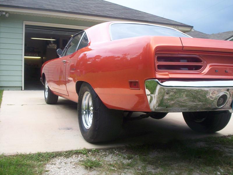

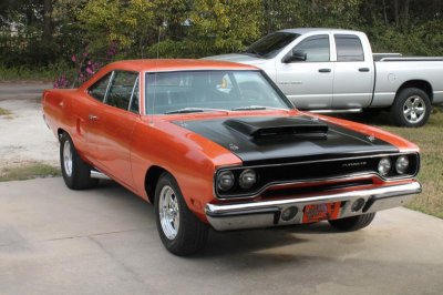

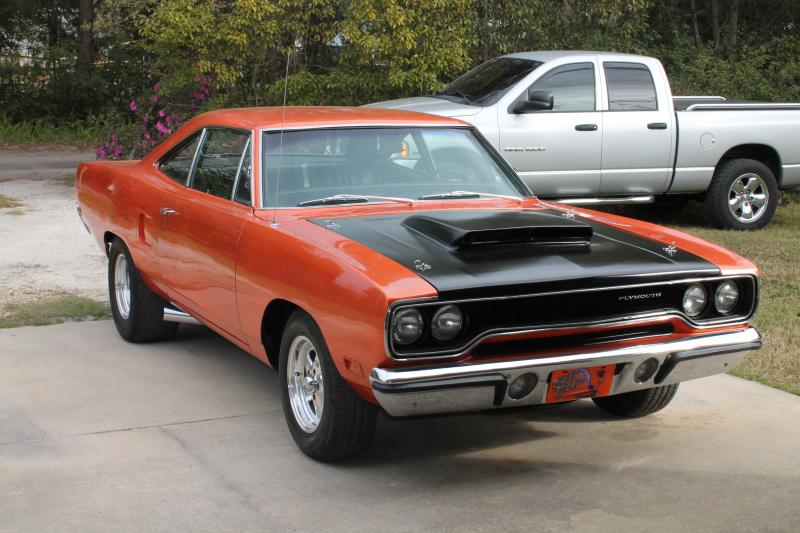

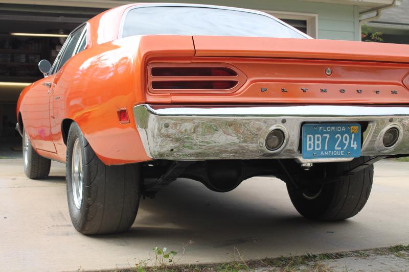

I'm guessing Et street rear? and Et fronts? Here' my RR. 325/50/15 and 215/70/15 for comparison.
No tub or re locator. A little trimming here & there and they fit with no issues. Super stock springs, 15x10 with 5" back space.
Thats bad ***!
Seeing is believing. Never would have guessed you could stuff a 325 in there. I always thought a 315 was pushing it. GTX Matt is right, it does look bad @ss.

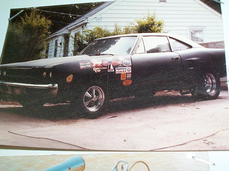

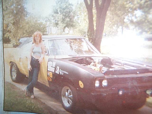

Here are some bad pics of my last RR. It needed a frnt cap when I got, hence the black front., to lazy, broke and dumb to just paint it stock yellow, so I painted the whole car with spray cans of flat black, before flat black was cool! Anyway those are N50-15s on the back of it in the all black pic and can't remember what size slicks on the yellow&black.

Here are some bad pics of my last RR. It needed a frnt cap when I got, hence the black front., to lazy, broke and dumb to just paint it stock yellow, so I painted the whole car with spray cans of flat black, before flat black was cool! Anyway those are N50-15s on the back of it in the all black pic and slicks on the yellow&black.
Who's the Babe?
Who's the Babe?
That was a neighbor's pesky daughter that tried like heck to get me put in jail.
