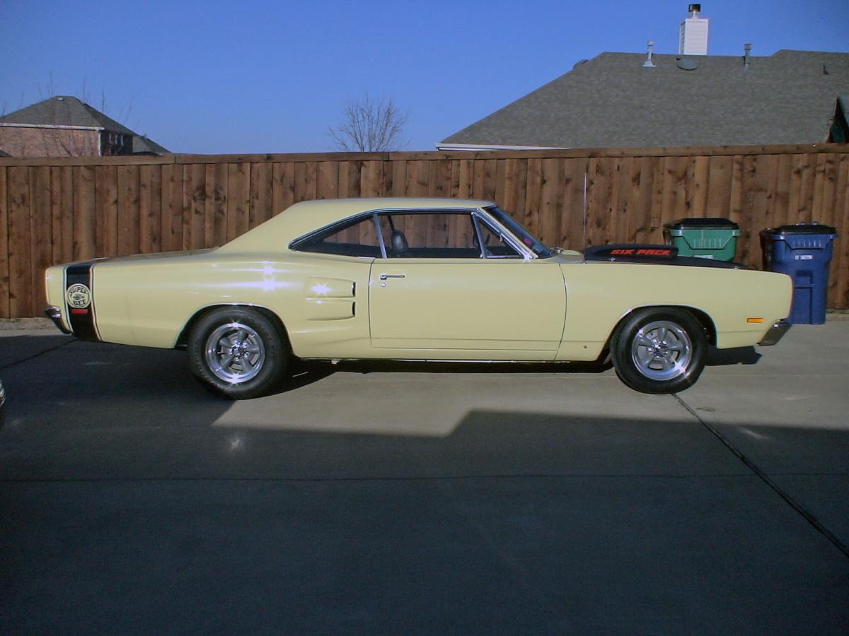

I just mounted a set of AR Torque Thrusts on our 69 Bee. I went with 15x7 front with 3.75 BS, and 15x8 with 3.75 BS. Tires are 235/60-15 front and 275/60-15 rear. Everything fits with no problem, and looks great.

I think 70 is a bit tall for a 15" tire, in my opinion. The tires we just put on replaced a set of F70 wide ovals, and I did not think they looked right. I know they are period correct, but just not my cup-of-tea. I like a tall sidewall, but that was too much. A 255/60-15 rear tire is 28" tall, which is pretty much stock height. With a 3.91 gear, you might want a slightly taller tire (275/60-15) if you drive much on the highway, because you will be screaming at 70 MPH. As a for instance, I have a 29" tall tire (255/60-17) on my Challenger, and I turn about 3,100 RPM at 70 with a 3.91 gear.

The Bee is a big mother car with huge fenders. I would be afraid that a 6" wheel with 205 tires would look too skinny, but that's just me. The F70 tires we replaced had a 7.5" tread width, but had a taller side wall so that didn't help. It's tough to tell in my picture above because my driveway has a decent slope down, but the rake with our setup is pretty good. I need to get some pictures with it on a flat surface.
