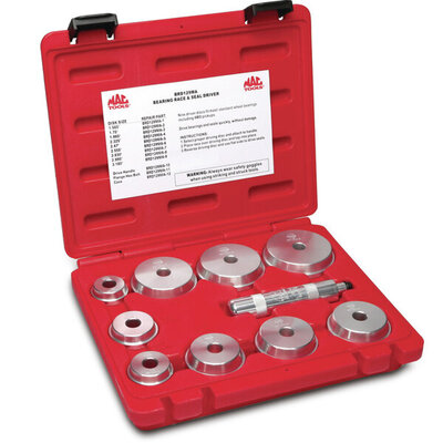

Yes, use a brass punch or a bearing race tool. Something like this: You may be able to rent or borrow a set from your local parts store or rental store.
https://www.mactools.com/en-us/Spec...a56101735e71/Race-Bearing-and-Seal-Driver-Set
