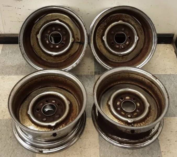

I found the ones in the attached picture on eBay for less than the cost of one of the 15x10 rears. I’ve refinished wheels before with good results, and figured this may be a good way of saving a significant chunk of money, and still having a similar look. Every dollar counts, as I still have to build a 440 for this thing!

Those wheels are not stock wheels. They look like wheels that someone should give you. The center caps you have located may not fit these wheels. Myself I would save some money and get something that will for sure fit and be decent.
Factory 15x7 4 1/2'' bolt pattern 4 1/4'' backspace wheels from the early to late 80's
rear wheel drive Mopars usually can be found pretty easily. I got mine from a 88 Dodge Diplomat.
$25 each.
Not sure if you have a pic a part yard in your area. Maybe place a want ad here.One of the members may be able to hook you up.
Those wheels look pretty "deep dish". Almost like the old chrome reverse that haven't been popular since the eighties.
Even with the deep dish, if they are 15x7, you should be able to get some decent tire size on them, but not near the biggest. The open wheelwells of gen one Chargers helps. I'm betting they won t fit on a satellite.
I'd throw one on each end of the car as is, no tire, and compare location to your current tt's, before I did any restoration work.

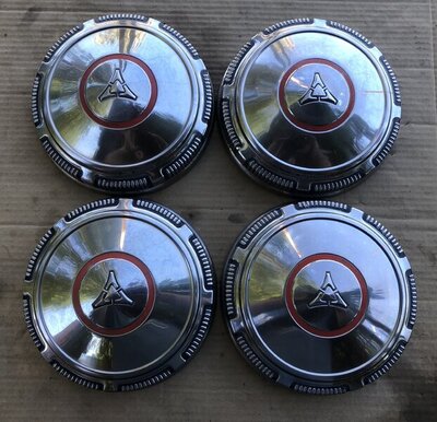

I would be very happy with that look, those are the same dog dishes I got, but they just have the little red ring in the middle. Good thinking on the want ad. While I would LOVE a 10" rear wheel, I have to remember this project is already going to be very expensive in areas that I can't control, so I should try and be reasonable in areas that I can. I would be extremely happy with $25 a rim, I will dig around. That would leave plenty of room in the budget for paint/powdercoat to make them look great.

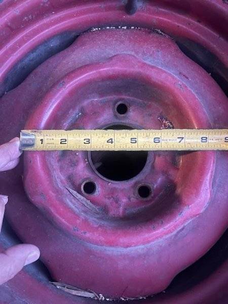

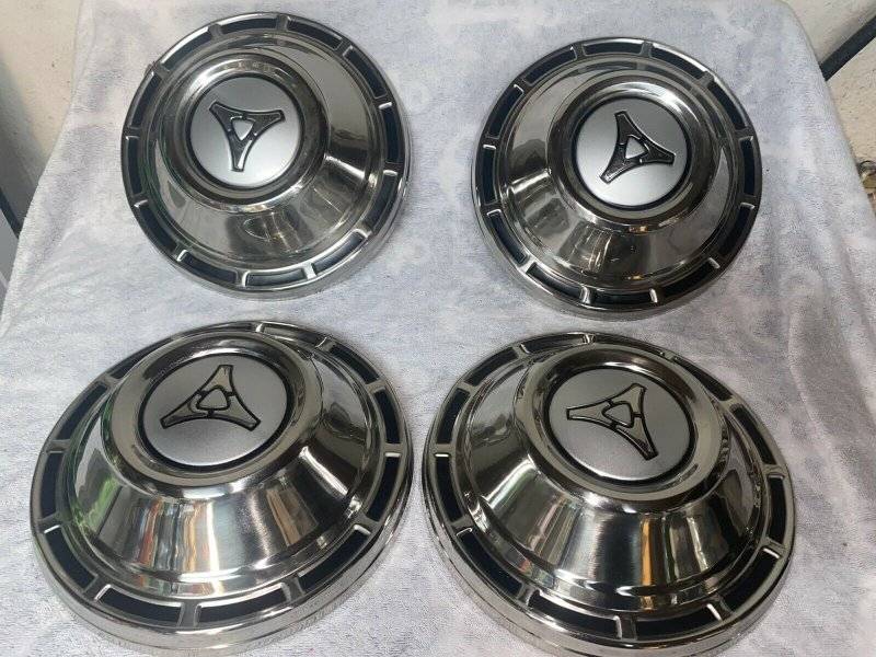

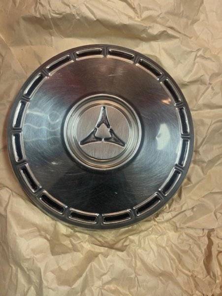

I have a 67 Charger, Measure the width of your dog dish covers before you buy anything. There are two different sizes 9" and 10" dog dish covers. I ordered a new set of 14" wheels from Coker Tire, waited 6 months, and the ring in the center was 10" wide and my covers didn't fit. I learned the hard way. Now I have a set of new Coker wheels with new 14" redlines and no wheel cover. I also purchased a set of 14 inch spinner hubcaps and they won't fit onto the Coker 14" wheels. So I changed to a 15" steel wheel, found in a junkard , which has a 8" center ring and my dog dish 9" snaps right onto the ring with no problem. Which dog dish cap do you have?

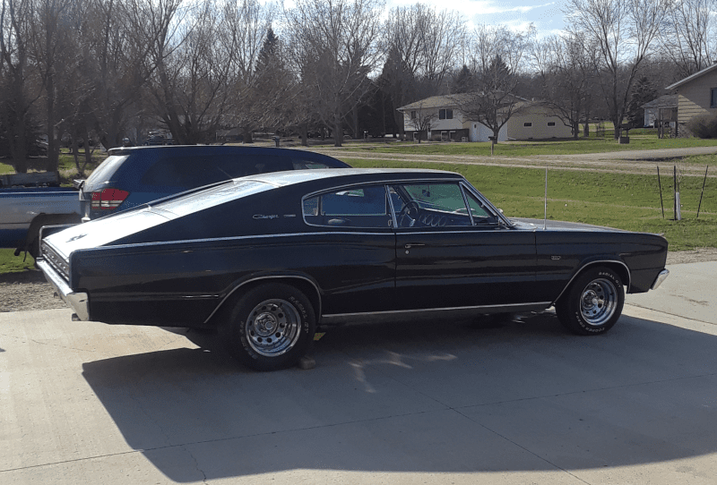

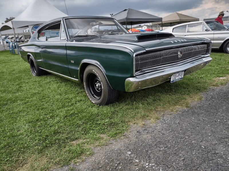

Have them all and others with the Fratzog, but chose not to use since I like this look:

I have 15"X8 on the front and 15"X 10" in the rear with essentially centered backspacing 4-1/2" and 5-1/2".
The 10" wheels required a 1/4" spacer.

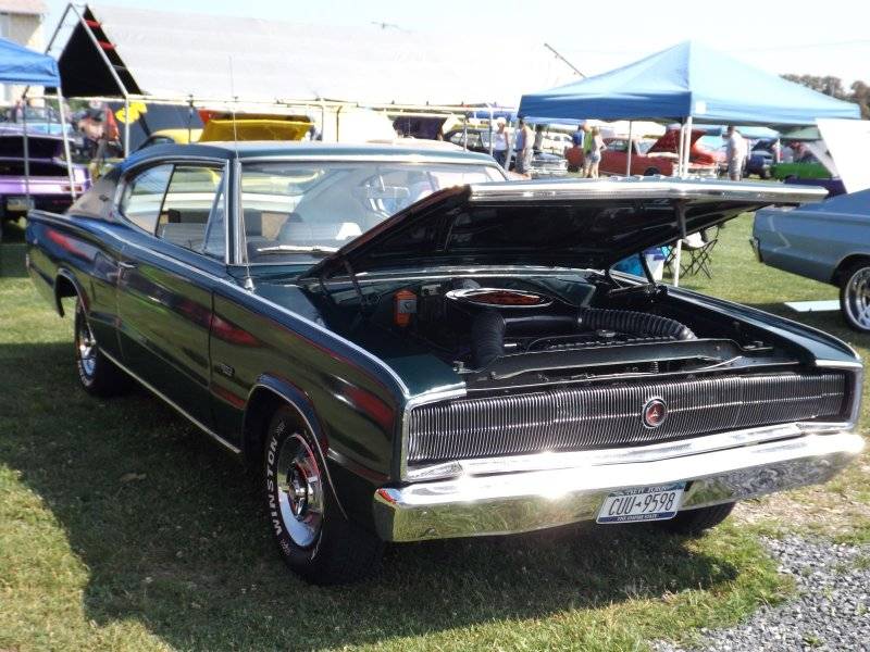

Don, I like the spinner hubcaps on your car. Are those on the 15" wheel?
Those are the original 14" wheels.
But I have 15" on it now the 14" wheels were just too narrow for me in the back.
I do like the original spinner caps as well.
A few years ago I started to mock up adapting them to a 15" trim ring. But the project stalled.
Maybe someday I'll get back to it.
