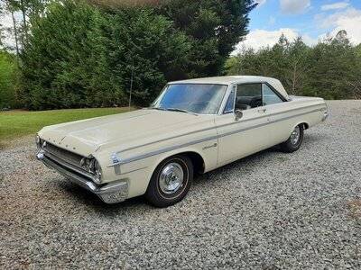

I have recently purchase a 1964 Dodge Polara 500. While I love the original hubcaps, I am wanting to install a set of 15" Magnum 500 wheels and tires. I am concerned about the backspacing. Does anyone know the original wheel size backspacing. I think it came out with 14 X 6" wheels. I would like go with 15" as the tires are easier to find 15 X 7"

Every car is a bit different as far as manufacturing tolerances when to comes to Mopars.

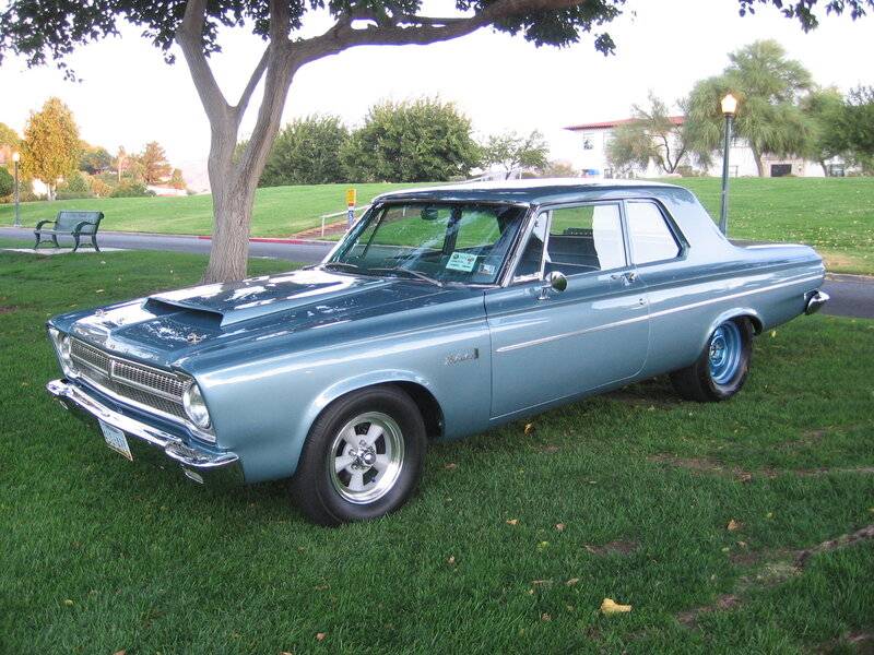

My 65, I run 15x7 with a 4 1/4'' backspace 275/60/15 tire.No clearance problems.
That same wheel and tire installed on my 63 Belvedere the tire on the passenger side is almost touching the leaf spring.
Factory 15x7 Mopar wheels will have a backspace of 4 1/4''

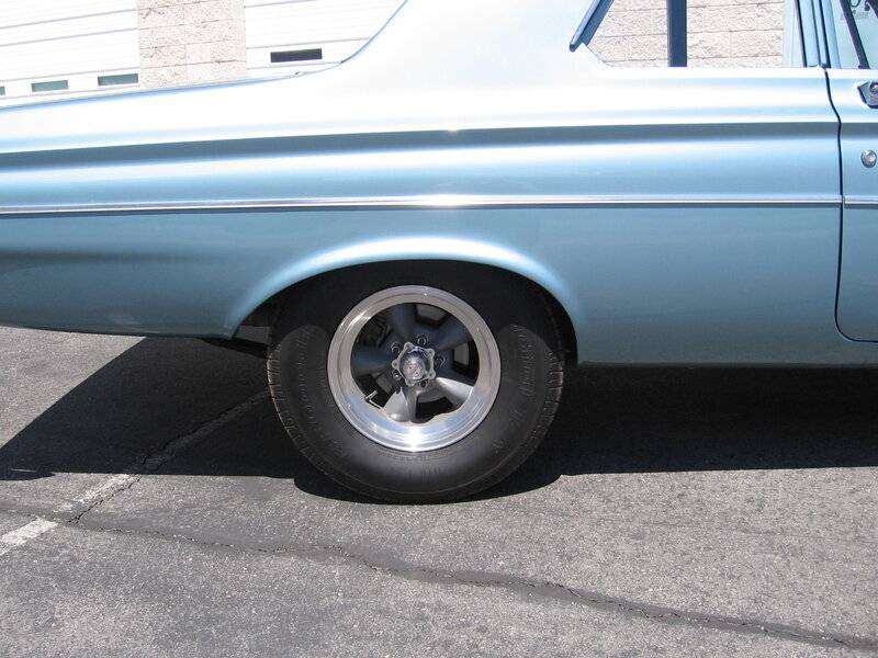

Early B bodies can be tight in the rear wheel well area. This photo is 15x7 with a 255/70/15 tire, 4'' backspace on the rear with no rubbing anywhere.
Photo of the factory steel wheel 15x7 with the 275/60/15 tire 4 1/4'' back space.

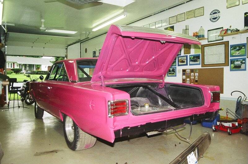

These are 15 x10 with 6 3/4 back space. Have 325/50R15 on them and fit right in! I just had to move the springs inside the frame rails, relocated spring perches, add 3" mini tubs, and had a fuel cell made. And we tell everyone that is as it left the factory. and it's one of one!

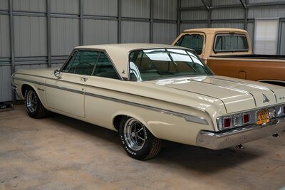

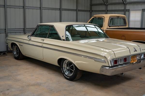

On my '63 Fury, I found a good more space than I thought going with Coker 15" Magnums. I could have gone 8" in the back having ample clearance. Shop friend put my car on an alignment rack so I could see what clearances I had before locking in on tire sizing. I have P235 60R's. In hindsight, wish I'd have gone to 16" wheels.

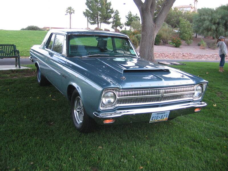

NO SUCH THING AS "LOOK RIGHT"!!! Your car needs to look like YOU want it! If ya see a vehicle here you like the way it looks ask that person what they did. For instance mine has been "slightly" modified. But it looks the way Rebecca and I want it. I had a 69 runner we ran in E/S in the 70's - early 80's ( before bracket racing was popular). I ran 15 x8s Smoothie's on rear ( custom made by Cragar) all of my cars have run 15x 5.5 or 6. Cause it is what we like. Both Summit and Jegs offers a tool you can get ( about $80) so you can see EXACTLY what will fit and give you the dimensions you need. Lots of how to videos on line to shop you how to use it. Called Wheelrite, real simple to use. Because what we have done to our 66 it does NOT like to turn ( by that I mean - in a brisk fashion). So pick a few you like the looks of and ask. : even go to the garage area. Everyone here is willing to give info. The look you get is up to you.
PS if ya paint it Moulin Rouge you will get a lot of: What the hell did ya do that for, same response it got in 1970. Our front are just a basic radial 205?75R15. Rears right now 325/50R15 moving to 295/65r15 exact same dimensions (Width, tread, section width) just 2" taller. Going from 28" to 30" Did my homework think they will fit? But of course will not know till mounted. My 15X10's have a 6.75' Back space.
