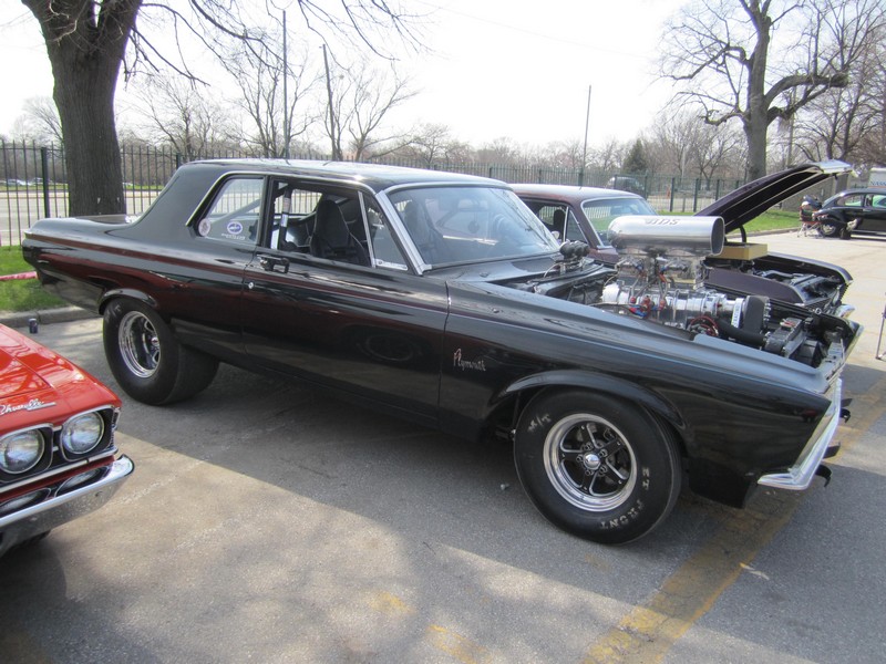

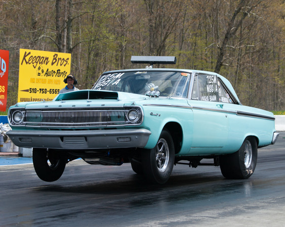

I run a mr. gasket 5/16 aluminum wheel spacer on my light blue dodge. Cheapo junk for the last 12 years and I go 8.90's @151 mph
Never had a problem. My hemi had them too for 10 years till I got the correct back spacing Weld wheels. Both cars run the same exact Weld alumastars.
