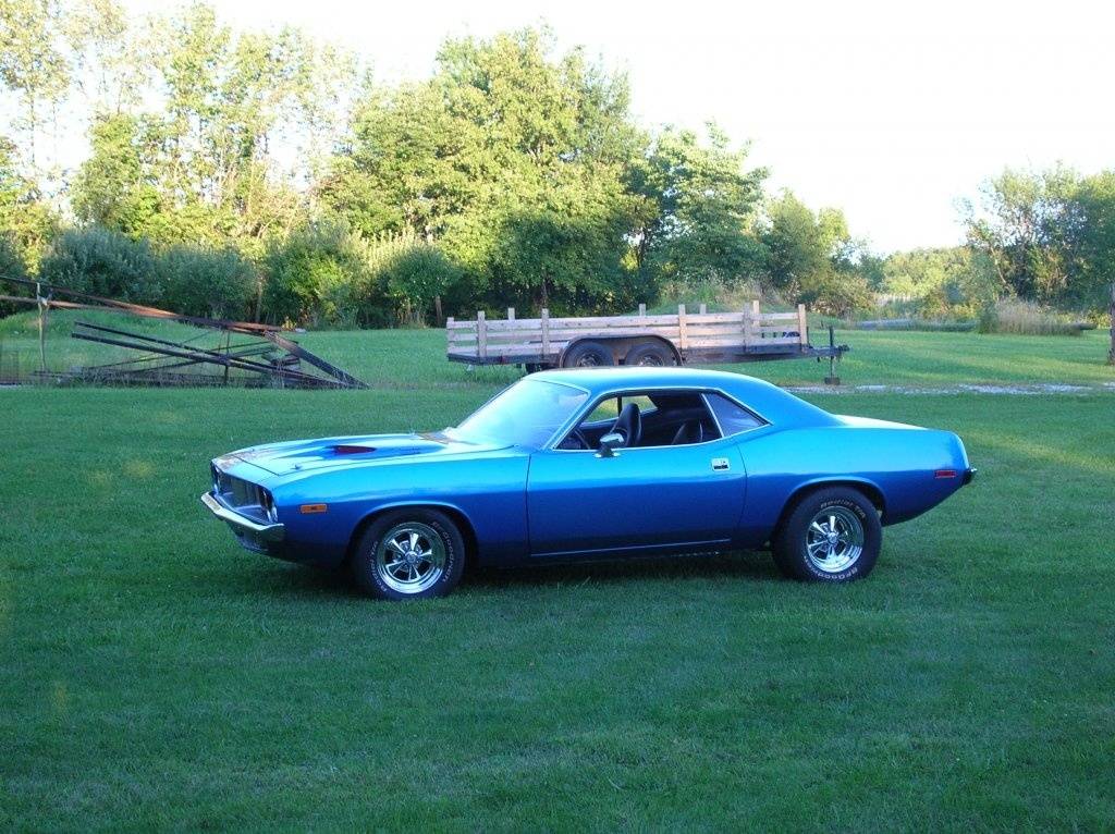

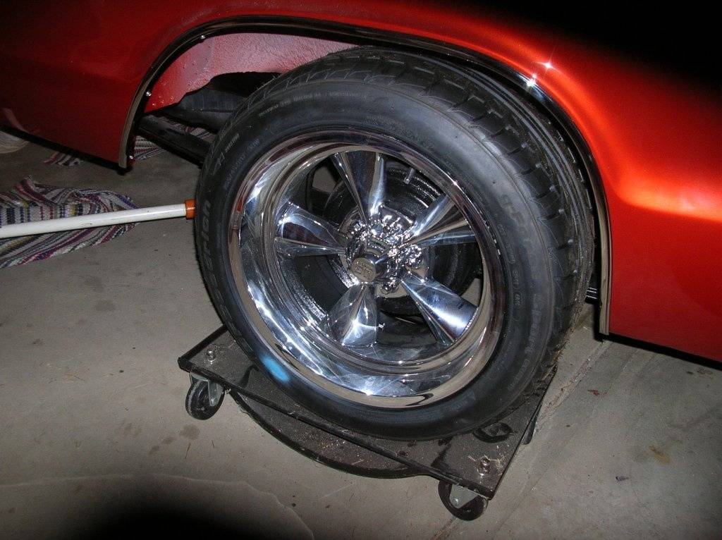

dragrazor....I wanted to do something different for my 67 Charger. I have 15" Cragars on my CUDA, 8" with 235/60's on the front and 10" with 275/60's on the rear. Good tires and make the car look good. For the Charger I moved to a 17" wheel while trying to stay in the margin of the original wheel/tire diameter. US Mags with 7" wheels on the front with 225/50's and 9" wheels on the rear with 255/45's on the rear. It looks good in the garage....waiting to get it out to see what it looks like on the street.
