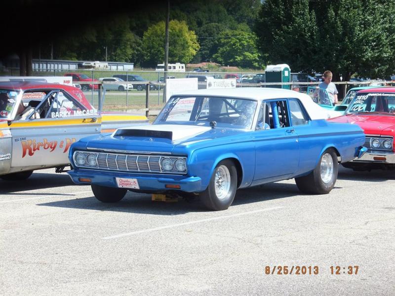

I'm putting 572 Hemi down in my 64 Plymouth and plan on putting a set of wheel bars on the car to keep the front end down just in case it comes up. I have a dana 60 with ladder bar, and a tranny brake, which brand & length should I go with?
Thanks Brian

car looks great by the way
