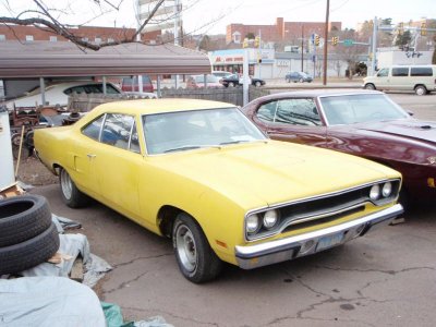

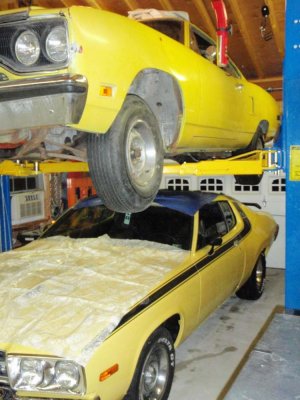

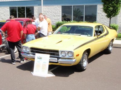

I have used on two of my Road Runner's (a 1973 and a 1970) a 15x8" rim on the back with 275/60R15 tires. I think they look really good, and fit has never been a problem - no rubbing or issues. For the front, I have used 235/60R15 on 15x7" rim.
I attached a couple of pictures. Sorry they are not really good, but hopefully they provide some help. I can take a more detailed picture if you like.
My custom 15x8 rims came from Wheel Vintiques. They are fine, and I have had no problems with them.
Hope this helps,
Hawk
Please ignore the first attached picture of the 1970 - copied the wrong one - it does NOT have the rear tires mentioned above. I'll add another post...

Here is the picture I meant to attach...

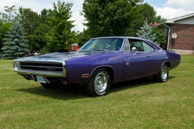

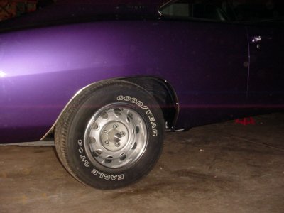

On my C7 70 Charger R/T i`ve got a set of 15x7 ralley rims with 245/65/15 Goodyear Eagle GT+4. There is lots of room & the car sits up real nice.

can you fit 15x8 up front and have steering clearance?
sweet...
I would not recommend it since the inside rim lip may hit the upper control arm/ball joint.
15X7 with 4" back space is tight but will clear.
