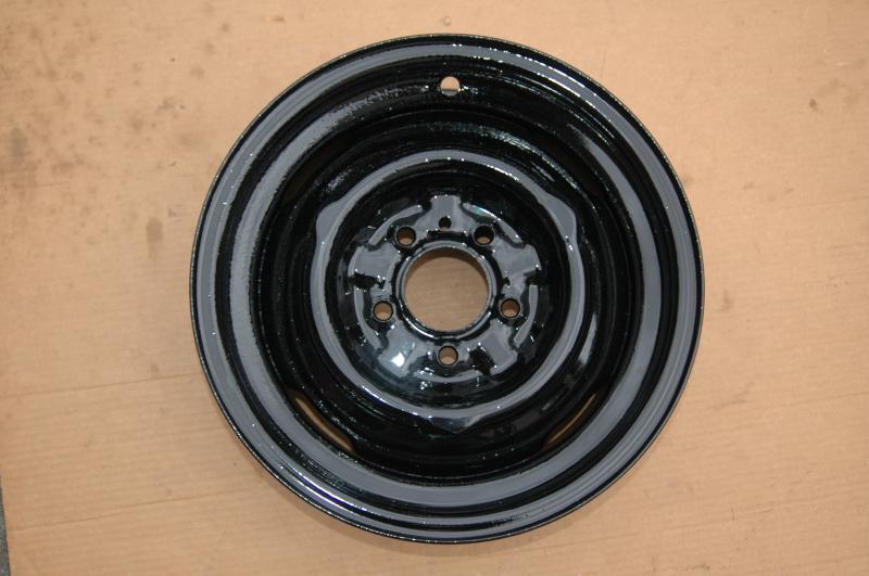

15 5.5 wheel
I have been following this thread, and will say that I do have 4 of the 15 x 5.5 wheels. Stock 1960's accepting the 10" button. I typically blast and paint black as per example below. Seems like everyone gets fixated on some exact size that really doesnt accomplish a big deal, ie: 5.5 vs 6", or is willing to make custom wheels and spend a great deal of money, vs getting what is out there if you are just willing to pay a reasonable price for stock.
I would sell my set, and can take a full set of photos. If you are more than a 'tire kicker', PM me with your email.

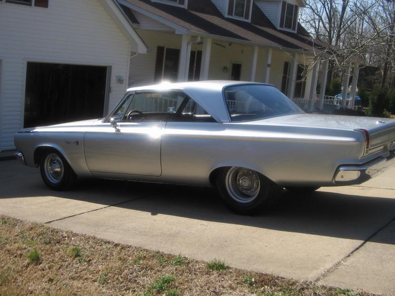

i've got 5 of those also with tires mounted. i'd like to put the centers in wider rims but the cost of that is a non-starter. the problem with selling them is, once they're gone there's no replacing them. i had a pair of 15x8's made, that will use the 9 3/4" cap, for my 65 coronet and don't use them anymore.
