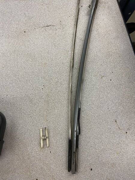

Front of front windows in track. What is the name for these.
Unobtainium is the current name! Lots on these if you search. Reproductions take a lot of work to make work correctly, hopefully you have enough OE slider "H's" that are still in good shape or you'll need to do some filing work on the repro's that are moulded wrong and are too wide. The original mylars were curved to fit the window, reproductions are not and require the outside "wings" to be trimmed off to at least work.

So if a friend says he can 3D print those clips but what about the plastics?
