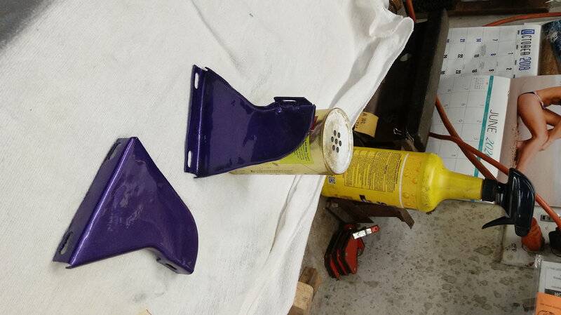

where do these brackets go?
charger10
3:43 PM
Nov 28, 2018
150
50
idaho
'67 charger. been years since I took it all apart. I couldn't fine any pics. of them in parts books or shop manual. I think they go in grill some where. I couldn't find any pics. of where all the splash guards go either.
'67 charger. been years since I took it all apart. I couldn't fine any pics. of them in parts books or shop manual. I think they go in grill some where. I couldn't find any pics. of where all the splash guards go either.View attachment 960516
Those brackets bolt the lower grill frame to rad frame, flat side up. Driver’s side bracket goes next to big round hole that holds the headlight wiring plug.
The pair of identical openings in front of the shock towers have metal shields and were always black from the factory.
DMT sells a extremely good splash shield kit, worth every penny.
