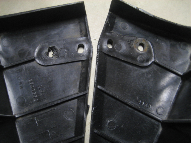

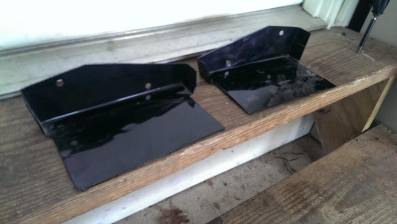

These came with the pile of parts for my 67 coronet. Does anyone know what they are or where they go?

Maybe bottom of front frame rails in between k member
What the???

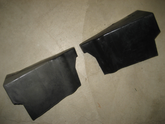

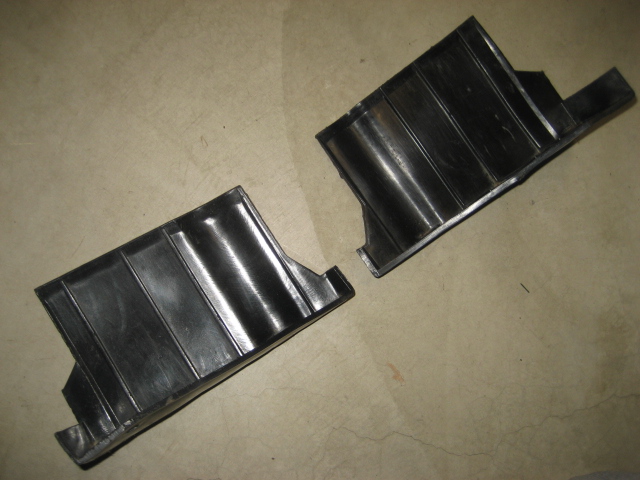

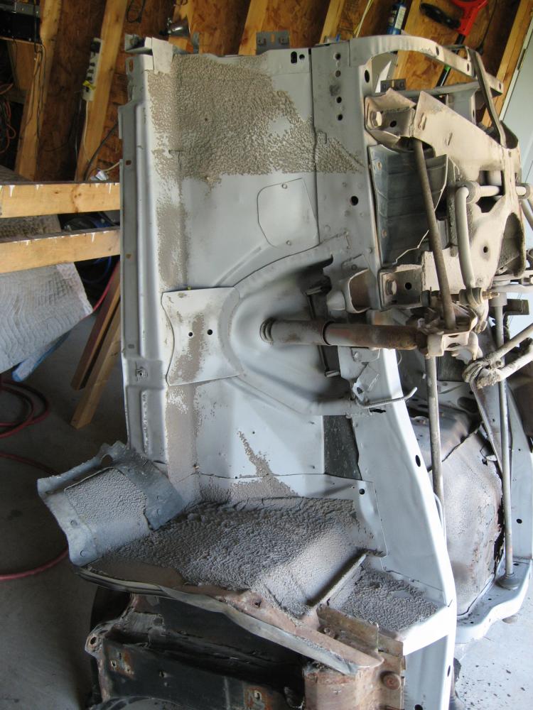

They look like homemade splash shields ,that are , like "Stewsta" said, riveted to the front bottom of the rail ,in front of the "K" member ,behind the rad cradle. Pictured here are the factory plastic ones. I thought these fit all 66-70 B Bodies, Just a guess, I guess ??

Mine are the exact same on my 66.
Great. Stand on your head when looking at the pics.
They are not homemade 66-67 are metal and bolt to the frame. My 66 has the same splash shields.
Yup...they were metal....changed to plastic in 68 I think. I know by 70 they were plastic.
69 are plastic too.

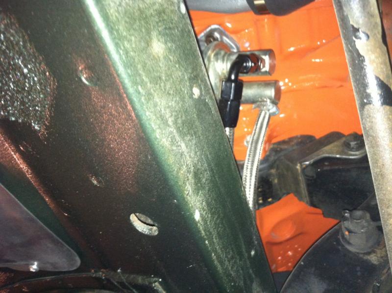

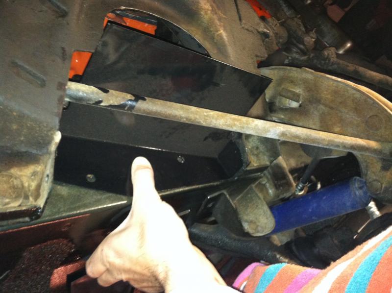

On the bottom of the rail between the front stablizer arm and the sway bar. It straddles between the two K-frame mounting members.

My Satellite is a '67 and has plastic shields - must have been a midyear running change from metal to plastic? Mine was built in the September 1966 timeframe.
