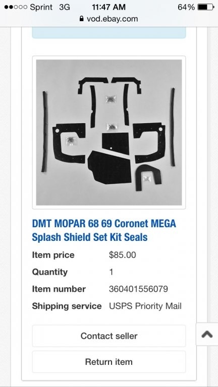

Where does this gasket go? I don't remember seeing anything like this when I took it apart. It's the one in the pick that looks like a big letter C with the hole in the corner. Pics are appreciated!!!
At the back of the front wheelhouse, from the inner fender, upwards across the fender then down the inside of the fender.

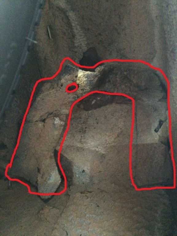

Behind the front wheel, towards the firewall. I took a picture looking back and up from the front wheel. This one has come loose, so you can see which way the hole orients. Give me a sec for the pic.
Wheels turned left, looking up and back into the driver side wheelhouse. This one is hanging down a bit at the top left corner, and covered in undercoating. But you can see the shape and orientation.

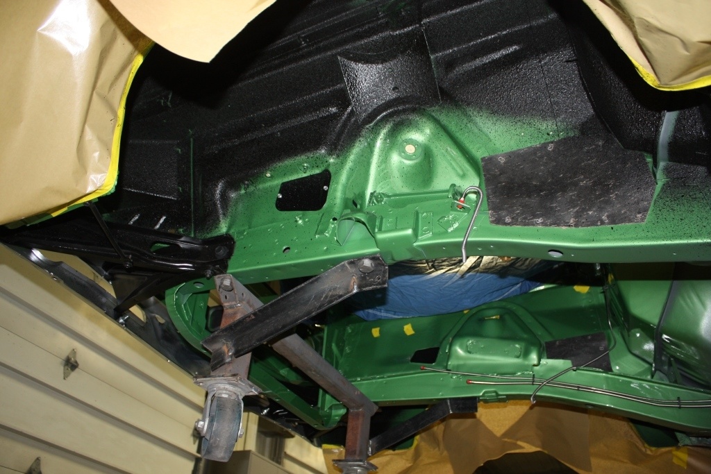

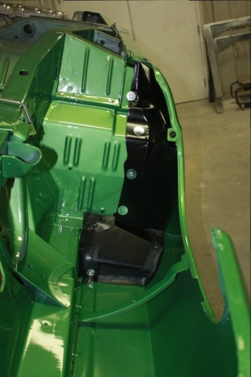

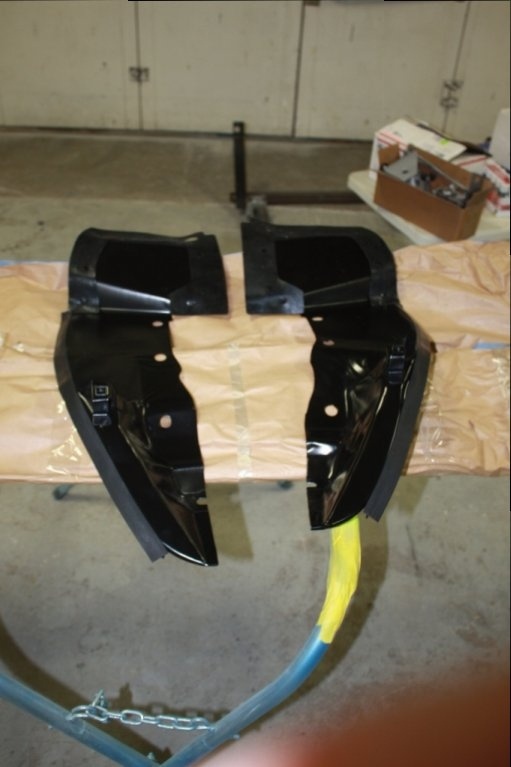

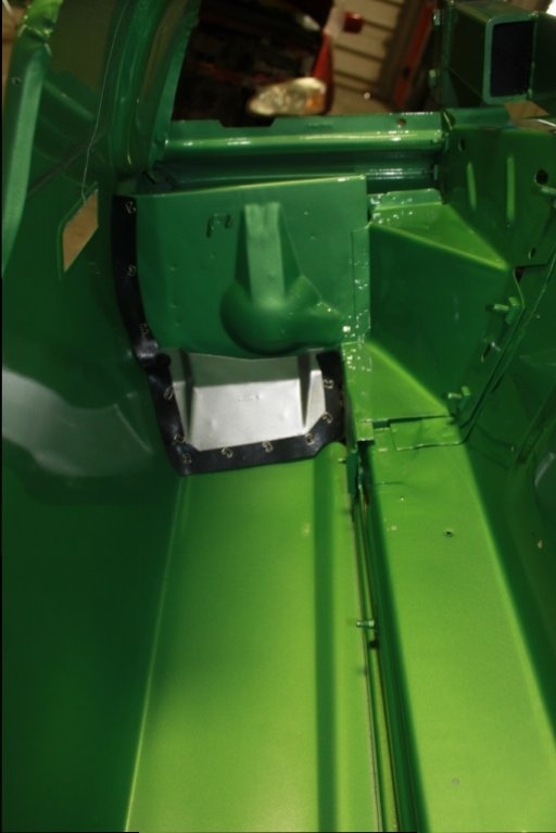

Here are a couple of shots of mine before I covered them with under coating. The last piece not shown in the pictures below is for the splash sheild on automatic cars.
Hope this helps.
