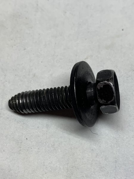

I found this lad on the floor under the front of my 68 Charger, forward of the radiator. It’s an inch long. Can anyone tell me where it might go?
Crawl underneath and start looking. What size is it?
Or bolt that holds the horns on. Many are used under the hood,fenders.

What size is the hex? That could help identify it, although the tapered tip seems odd for a Mopar…
It’s a 1/4 x 1 bolt. Everything to do with the hood latch is there and so are the horn bolts.
Can't believe everyone missed the fact Mopar doesn't use a bolt like that.... That is a Sems body bolt, used on GM's... See the pointy threads? Not from a Mopar... Somebody may have used it on a Mopar but it didn't belong there..
Okay, I see Black Sheep pick up on it.... And 440-4spd is saying Mopar did use them but I've worked on hundreds if not thousands of 64-72 Mopars & never seen it... By the late 70's maybe but those don't count... Cause the car in question is a 68...

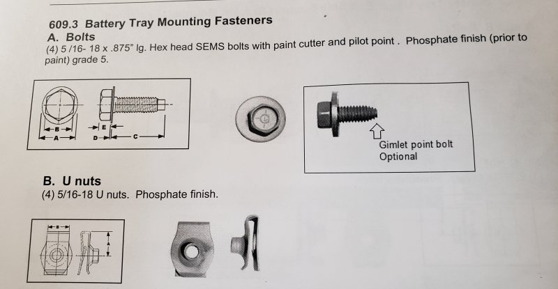

May be the optional Gimlet point bolt from the battery tray support ????
but not sure.... I think horn bolts have grounding teeth on the washer?
