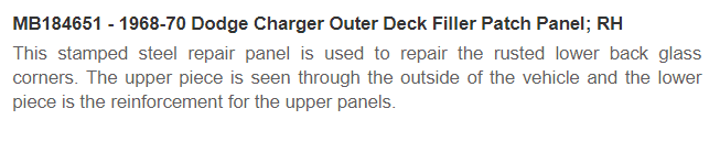

this is the description of classic industries

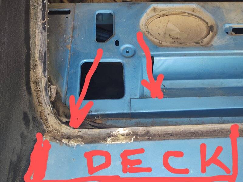

That pretty much tells you exactly where it goes.....to me, it's the window channel that the glass goes into with the window gasket. The corners usually rust out on most of the cars that ChryCo built as there's no place for the water to go once it gets in that area.
Left side shown:

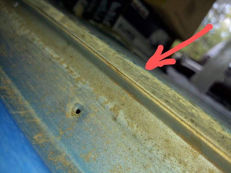

The left arrow points to the part you asked about. The right arrow points to the part pictured below.
The arrow below points to the deck panel which is the piece that runs from the rear window frame to the forward gutter of the trunk opening. It looks like this deck panel turns down and attaches to the lower window frame pictured above.
I don't believe the AMD corner pieces are substructure. I believe they are intended as patches for the window channel corners. I bet it's a pain to join to the deck panel and make it look nice.
If your rear window channel is in really poor shape, then you might want to replace the entire deck panel, the lower window frame piece pictured above along with the left and right corners.
Hope this helps and good luck.
