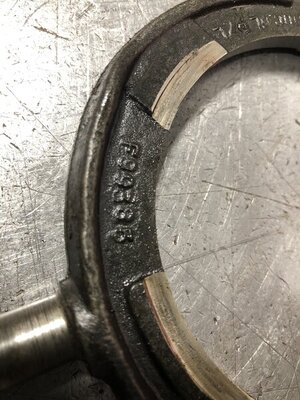

Tearing apart our cast iron A833 overdrive we found the 1-2 fork pretty worn.
I called Brewers and they don't have anything.
Tailshaft is marked C-8853? Front bearing retainer is marked C13157? Fork is marked F99385?

Large front bearing retainer may require the bell housing to be opened up. How much wear depth on the fork? How does the rest of it look? Clutching teeth, slider hubs, brass, bearings?

A little wear on the fork wont kill it. Once the slider moves over the struts itll fall into the next gear. I've have good success filling worn clutch hubs. Slow with a sharp file . Grind the edge off a file so it fits down in the tooth. Time consuming . The result was a very good shifting trans. You can sharpen the points on the clutching teeth with a Dremel using the small cut off wheel. Obviously the bearings and shafts have to be decent.

Steel forks have a double step on the shaft. You can cut the 1st step off and use them in place of brass. Brass will not work with the late cover that started out with steel.
Doug
steel forks can be welded and resized...that's why I asked, if you cant find one put a bead of weld on it and bring it back to the thickness it needs to be.
