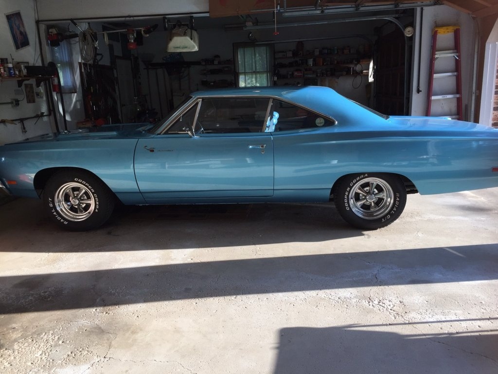

My '69 Road Runner has 245/60/15's in the rear (225/70/15 up front).
