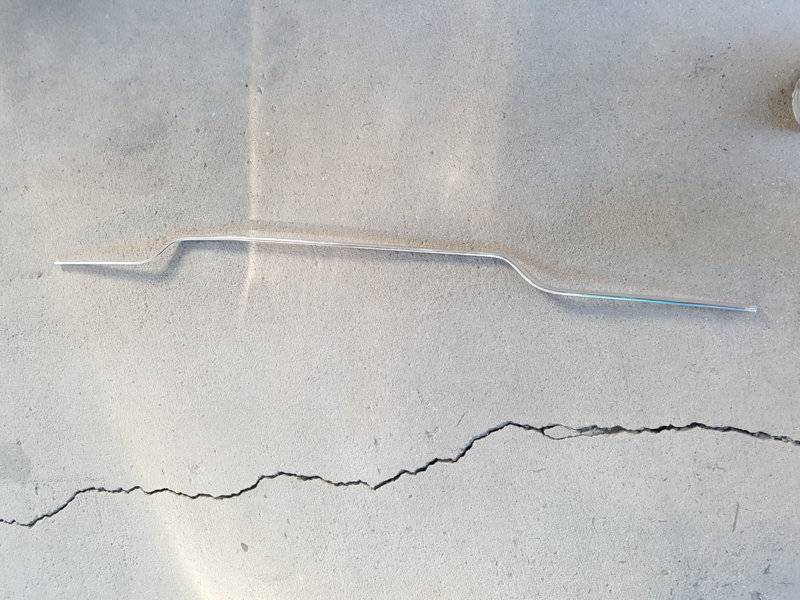

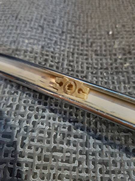

Hey all. Trying to locate the plastic clips that are used to fasten the rear chrome trim that goes across the back of my '70 Satellite. You can see the full piece, and then a close up of one of the old plastic clips. I assume screws went from inside out to hold it. Any chance of still getting these clips? Or has someone come up with a different way maybe? Thanks.

Auto body paint supply stores often have an extensive assortment of clips
That clip is missing part of it. It has four fingers. That push on the hole. Then a round plastic dowel pushes through the center to spread the 4 fingers. They are the same as 70 Cuda rear panel trim. Not barracuda, but a real BS Cuda.
No screws from the inside.
