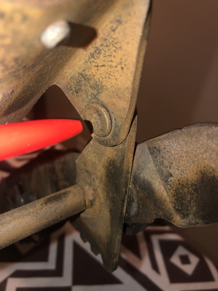

I’ve got a ‘70 6-way bucket seat frame that is bent & I need to straighten. It looks like I need to remove 3 of the rivets, straighten 2 pieces and replace the rivets. Where can we buy these? THANKS!

Is this a concourse restoration? If not I have reused the old rivets. Grind off the peened end and drive it out. It may be tight. Then put it together and with a wire feed weld the rivet in. If you just hit the rivet dead on with a couple bumps with the welder you can almost duplicate the peened end you ground off. Little careful grinding and you are done.

Nope, functional restoration. I’ve considered grade 8 bolts
Do what I said to the rivets. You can make quick work out of it.
Thanks. I'm leaning that way except I found the double shoulder rivets.....I just have to see if I can buy less than 10,000 at a time. If not, re-weld the end
