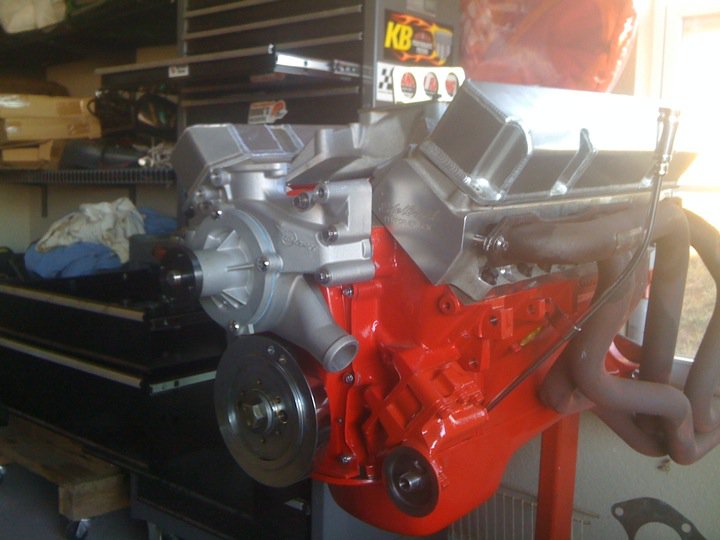

All right guys. I have talked myself into a pickle. I am about to get my car back for the body shop in a couple of months to start putting it together. I currently have a 400 "with all the goodies" on it. My car is an auto car, so was just going to but a 727 in it and be done with it. Well, as you all know, gas is continuing to rise and I want to be able to afford to take this car out every once and a while and not spend $100+ in gas in two days. I want to drop a modern Manual trans in it, but I am not sure of all of the options and how hard each option would be "surgically". My father-in-law owns a salvage yard, so I can get my hands on about anything. Also, I have been debating on going ahead now and just dropping in a 5.7 hemi. What are your thoughts? I love the car and I want to be able to drive it without burning a hole in my wallet.
