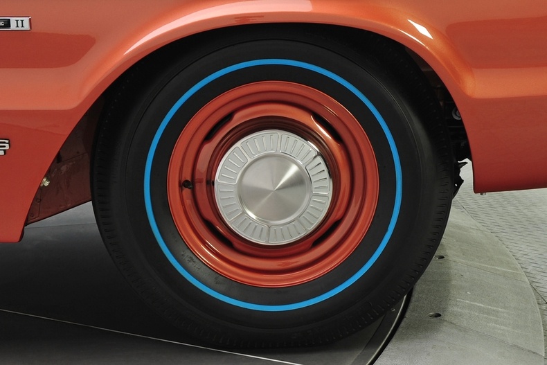

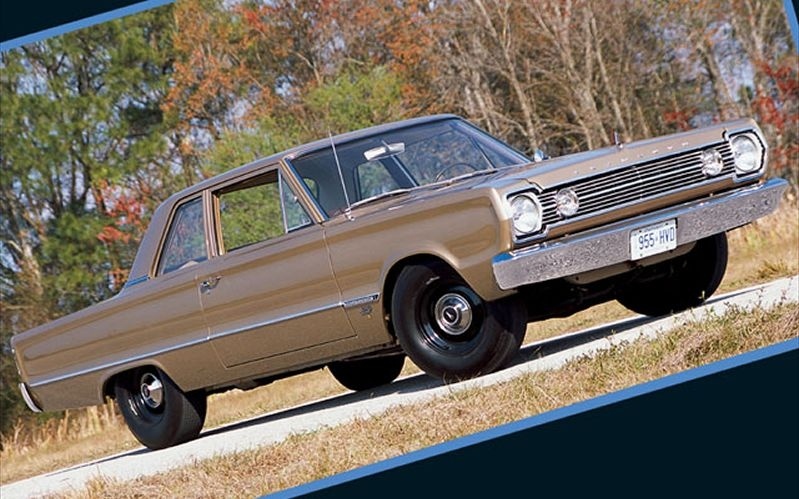

Wondering if anyone knows which of these two cars has the correct hubcaps. I have a '66 Belvedere I and would like the correct year hubcaps.
As far as I know, the top one has 65 Belveder caps. And the bottom has 68 Roadrunner caps.
I am currently running standard dog dishes on 15" rims. I believe from some research that these ones are actually larger diameter than the dog dish's, and they fit on 14" rims? I may be way off. I would hate to go to 14" rims.
Yes they are the larger 10 inch dog dish caps. The 10 inch was used from 1967 and down and changed to 9 inch caps after 1967. I have a set of factory 5.5x15 inch steel wheels which were used on early 1960,s dodge half ton trucks.They are very hard to come by and expensive. I also have a 66 Belvedere that have later 15x6 steels wheels but bought some adapters from a guy on ebay a couple of years ago. They are basically rubber hose made into a ring.
They attach with black silicone gasket sealer. I have had mine on 2 years and no issues. But the 66 caps are 10 inch and the 14 inch rims are what came factory.
I think I read that someone also Gorilla glued the 10" right over the smaller ones. Not sure I would glue the things on!
