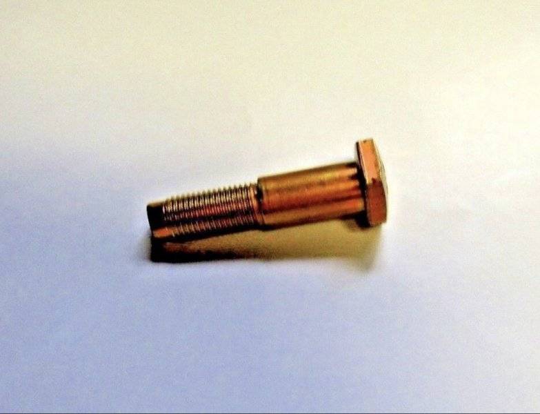

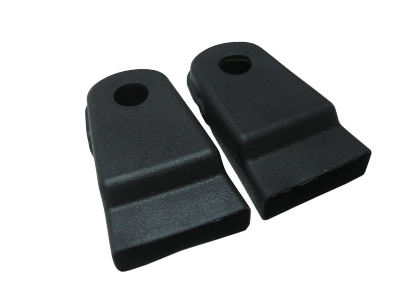

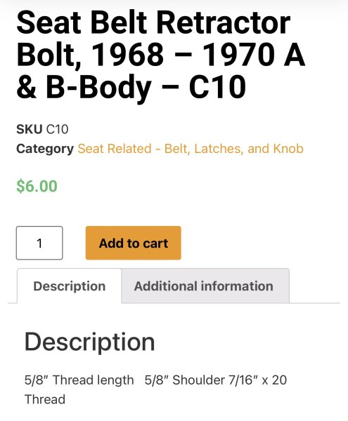

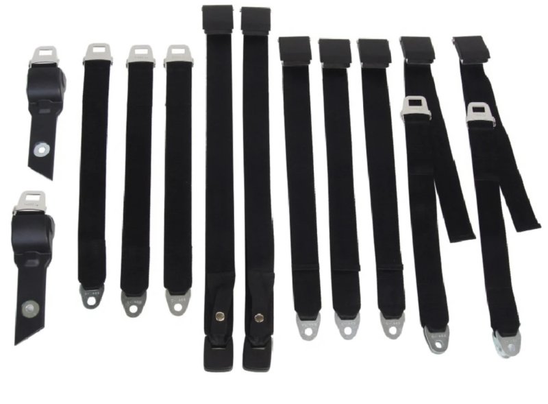

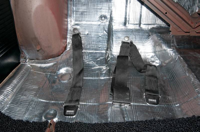

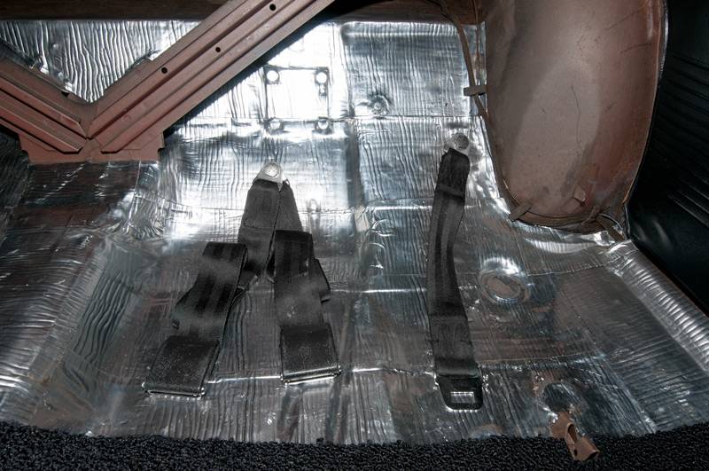

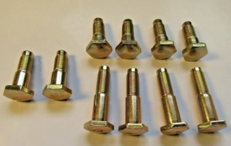

The 68 Charger I recently bought has no seat belts. Before I start searching for belts and hardware, I need to know what to search for. Can you folks please provide pics and details of correct belts, covers, bolts, etc. including proper installation?
It is my understanding they came standard with lap belts only and all shoulder and center belts were optional. I am looking for everything I need to install two front bucket lap belts and two rear belts. I am open to making 3-point in the front if it is a simple bolt-in operation.
This is not a numbers matching concourse show car, but I would like to get things as correct as possible within a reasonable budget. I don't want to end up paying hundreds of dollars for a set of bolts that can't be seen when other less expensive bolts may do the job safely.

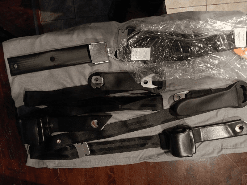

i finally found one missing belt in my garage i have correct 3 point front set that was sent out for refurbishment 100.00 plus shipping 15.00
My 68 Charger was missing some of the belts when I got it. I bought a new correct set from B E & A Auto back in 2014. $445.00 back then.

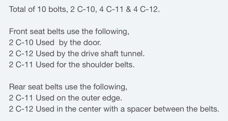

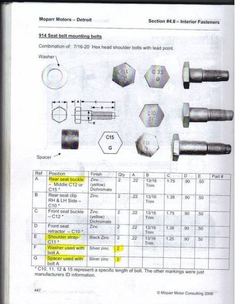

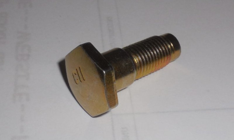

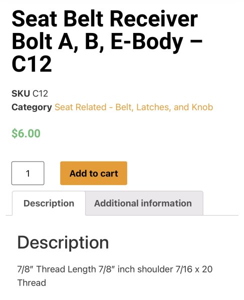

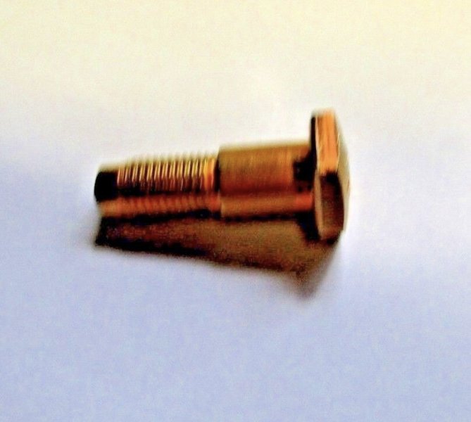

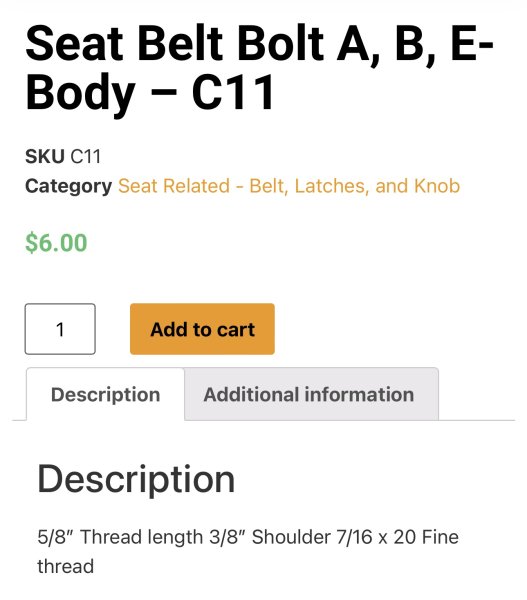

the above post with the parts reference in the book indicates the same except one difference. The book says C10s go on the rear outer belts and you say C11s go there. How big of a difference is that? Only the length of the bolt or non-threaded portion of the bolt right? also, does every belt anchor point get a washer? Do only the rear center anchor points get a spacer? How big is the spacer? Isn't there a soft felt washer or spacer somewhere in the mix? Thanks.
