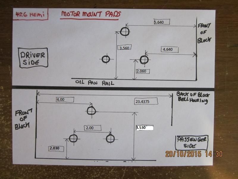

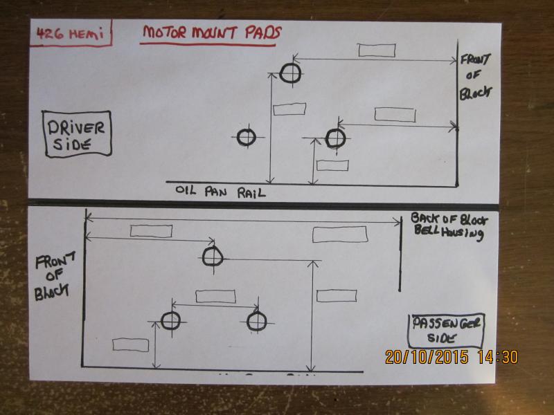

I need a few more measurement to verify what else is wrong with my plastic replicate block. I made a sketch of what I need. I'm thinking I may be able machine it down to the correct dimensions. Hemirunner, I sent you a PM. IMG_2685.jpg
65AFX,
Take these with a grain of salt as they are probably within .015 but will give you what you need.
