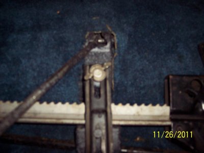

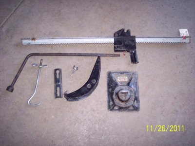

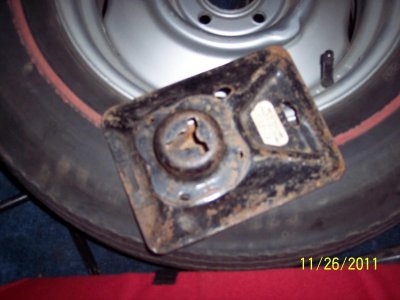

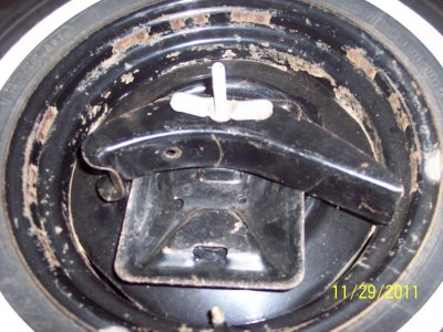

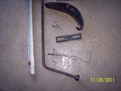

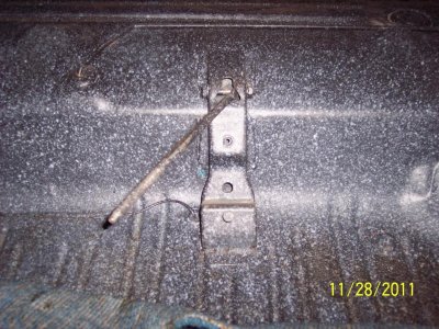

Need to find out what I am missing besides the wing nut anyone have a pic of the jack in the trunk without a tire?
69 b-body jack

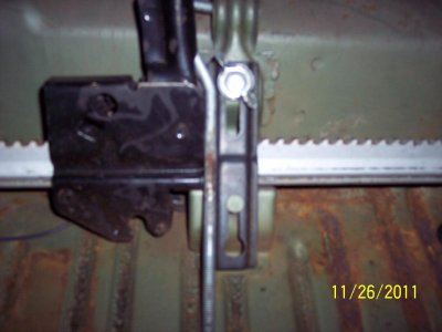

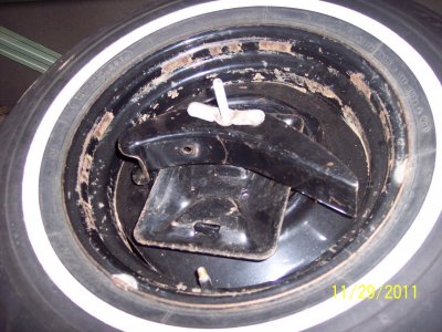

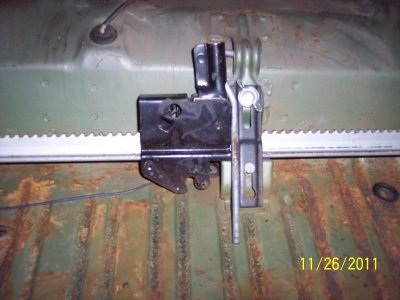

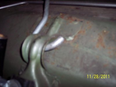

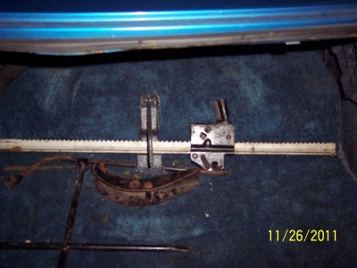

Her are some pics that should help you out.The pics are of an original 68
Sat which is the same jack as a 69.

That looks exactly like the jack and stuff in my untouched '68 (at least until the guy I got it from) Still have the dang 14' bias ply spare in there that's never been mounted. I had to get another spare just to feel safe.
Actually the t-jack was changed in 69 to sightly rectangular jack due to safety issues with the t-jack sometimes kicking out. I learned this when restoring my trunk floor pan. Bought a new jack off e-bay, took it to a show and one of the judges pointed it out as i had bought a 69 jack. Worked for me as I had to use it a few times and had no issues.
COOL THANKS! Now I know what parts I need to hunt for got most of it just need a spare tire lol any got a pic of a 69? Looks like the hook mount is a bit different.

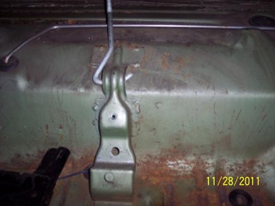

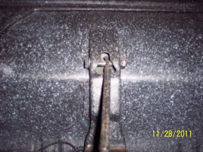

Funny cuz I have all the gear in the first set of pics but in your second set of pics you have the body brace and a rod with a pin for the tire mine is the hook like in the first pics so i made it fit in the side holes of the brace lol seems to work, guess that was the missing puzzle piece the rod with a pin and a wing nut need wing nut either way. Thanks for the pics.
holddown
I will take closer look tomorrow but I think you are right,it looks like the holddown stud is different between the 68 and 69.
The top pics are 68 and the bottom are 69.
Jeff
sparetire holddowns
The first 2 pictures are 68 and last 2 pictures are 69.
Jeff

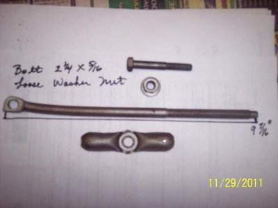

mine looks like the the 69 for sure guess i just need the right bolt and wing nut...have not seen any of those u know were to get one?
Can you put it all together so I can see it complete?
jack

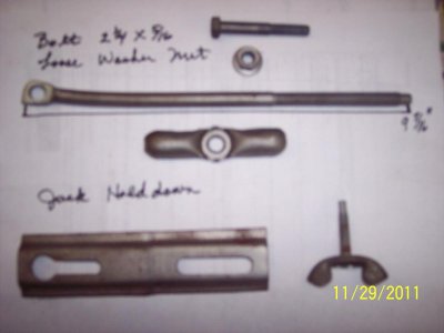

Some more pictures of holddown parts and parts as used.
You can look at the other pictures I posted.
Jeff
