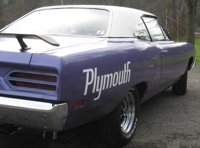

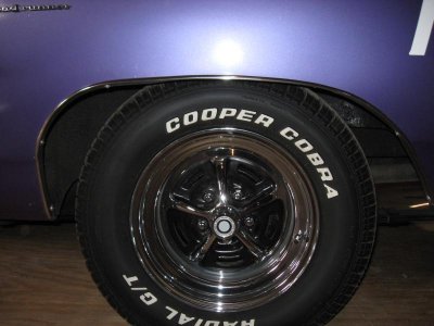

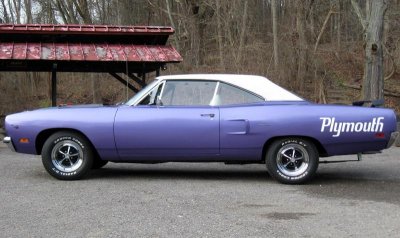

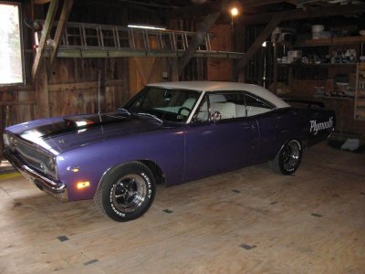

i got 'em BIGMAN.. HERES PIX, AND THEY ARE 15 X 7 MAG 500'S AND THE TIRE SIZE IS 255-60 COOPER COBRAS
rides like a dream....no issues what so ever...and theyre STICKY! A FEW ANGLES FOR YA ! HOPE IT HELPS!

That's great the 255's are what I was looking to get. A friend suggested 17' wheels with low side walls. I do not want to feel the road there is enough vibration from the 493 :)
someone that tells you to put 17" wheels with low profiles on your classic MOPAR ....IS NOT YOUR FRIEND! we are your friends and youll love the 255's trust me:headbang:

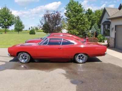

here's mine fronts are 225/60/15s on a 7" rim
backs are 275/60/15s on a 8" rim

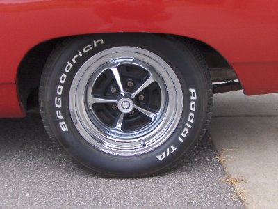

235/60 15 all the way around.
What backspacing do you have?
im not sure but i think its 4 1/2. i never really measured...ill find out
ok BIGMAN...heres the ebay listing when i bought the mag 500's...its 4 1/4 back spacing....
MAGNUM 500 MOPAR CHRYSLER 15"x7" WHEEL/RIM KIT: w/BULLSEYE CENTER CAPS & CHROME LUGNUTS
This is a set of our popular Magnum 500 wheels with the Bulls Eye center caps for your Mopar.
Set includes (4)-15x7 wheels, (4)-Bulls Eye center caps, and (20)-chrome lug nuts.
Backspace-4.25" Sold For:US $719.70
i used the ones that came with the rims. theyre about1 1/4 inches long...hex ( naturally) with round closed ends!
Looks great! How did you get the stance just about level with the tall 28" tires in the rear and the 225/60/15's which are 25.6" tall? I have 235/60/15's front and 275/60/15 rear on my '68 satellite and I can't get rid of the rake without a huge gap between the top of the front tire and fender lip. Did you lower the rear of your car somehow?
Sorry just seen this, No I didn't lower the rear it does have new rear springs on it (mopar performance) and when I got the front end alined I turned it about an inch. thats it
very nice!
Nice! I'm repainting my 67 bright blue metallic (same color as my old 68 GTX). I really like the wheel lip mouldings. Do you recall where you got them?
