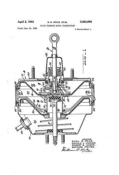

I tried to get one apart several years ago (didn't have the manual back then) but it was a very rusty unit and I never got the bakelite plate (the one between the diaphragms) out of the rear housing for some reason?
No bakelite between the diaphrams, is a metal tube attached whit 4 bolts to the bakelite.
Sorry any pics but one escheme
