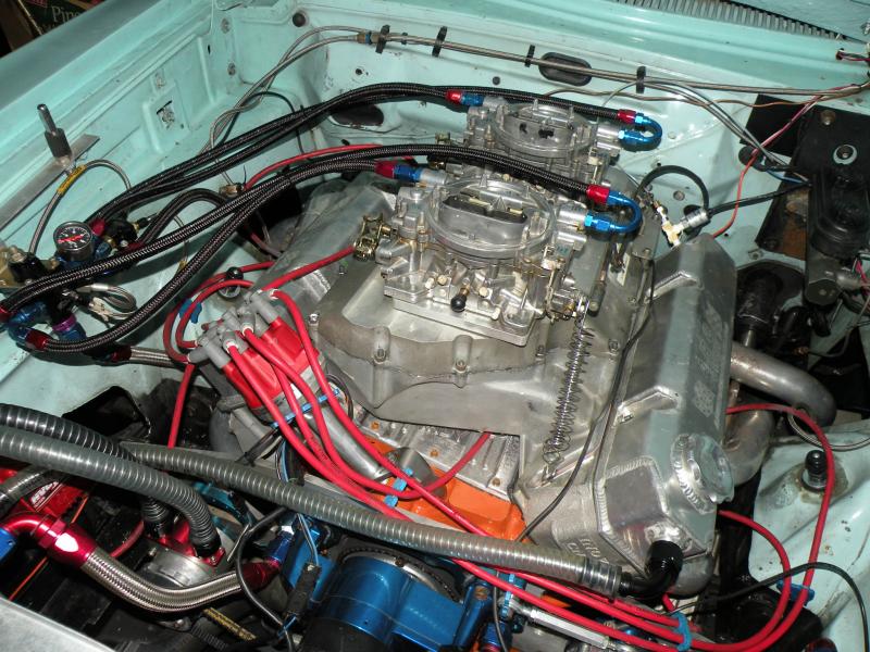

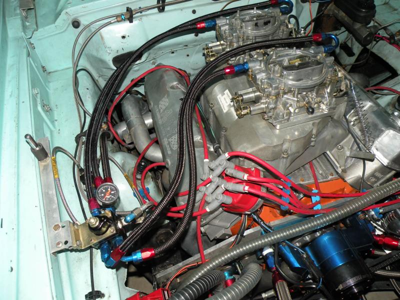

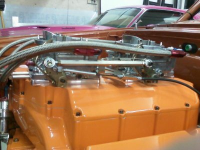

What are you guys doing to stagger jetting on 1 side of your engine?
If your rich on passenger side, what side of the carbs do you lean out with metering jetting,passenger side or drivers side?
This particular intake is a inline no offset indy 440-25 max wedge intake, no offset to it.
heres a pic.

Trouble is you don't know which cylinder(s) are rich without testing individual cylinders. I haven't seen anyone running staggered jetting. Which Plugs show rich? You'll notice that 2 out of 4 throttle bores sit right above 4 out of 8 runners.
front carb RS primary cyl#3 rear carb RS primary cyl #7
LS secondary cyl #2 LS secondary cyl #6
If its one of those cylinders I would lean that carb bore.
Doug

Racepak is showing passenger side bank. From my experience i'm betting 6,8 to be richest. That's usually the case. So what side of the carb would you lean out? Opposite bank? Would you lean out drivers side carb?
Rear carb drivers side secondary jet feeds 6/8 fo the most part.
Doug
Doug
i Just set up another pair of Jakes carbs with .113 on throttle side,prmary and secondary and leaving .116 on passenger choke side. I rejetted both carbs.lets see what happens this weekend.This should lean out the passenger side engine

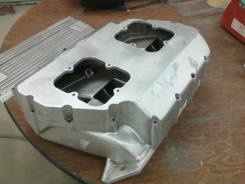

whats the height of that intake, i am putting one on my 505
7.90 inches tall.
