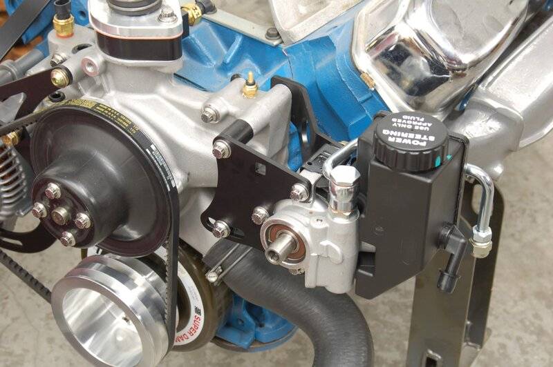

Depends how serious you are about using a better pump. I'm not a fan of using 50 year old technology so I fabricated a set of brackets that allows me to use a modern PS pump.
Not a fan of 50 year old technology.....sure looks like a B block mopar engine in your pic..... Designed in the late 50s . Has iron heads on it no less. The "new" pump you have there is just the same vain type pump as the old tec just no external can. nothing wrong with a Saginaw pump. .

That's pretty awesome looking setup, I am just gonna rebuild my original, I have it torn down and a kit on the way.
