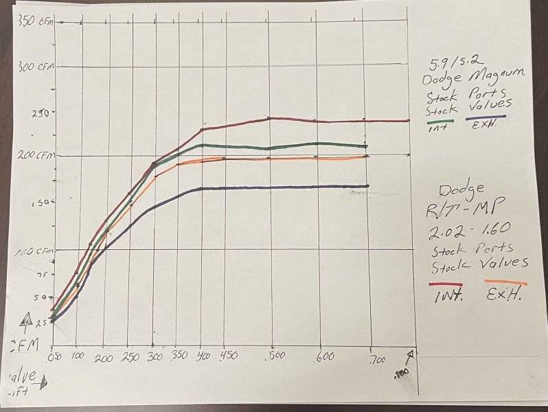

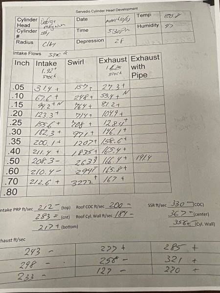

I have a video scheduled on this with flow charts and port speeds on the as cast head vs the (unobtainium) Magnum R/T 2.02 head.
An Edelbrock head is a better route with better cooling abilities. You’ll have to check the Edelbrock website or the Hughesengines website for the Edelbrock heads flow rates.

For what it’s worth…. A pipe dream for my Magnum. I happen to have Magnum R/T heads as well, so… IDK how well they could be ported out or if there even close to what’s used in part two below, but I just love that torque line!
