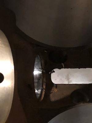

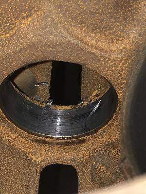

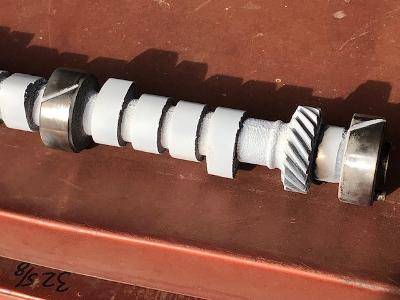

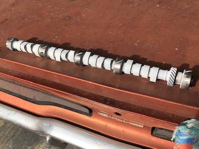

Nowadays, I use THIS to clearance the bearings in a rebuild....
I cut diagonal grooves in the journals and fill them with bearing grease.....then slide the cam in and rotate several revolutions. This is done before any assembly is done so the shavings can easily be retrieved. This will knock down any high spots.

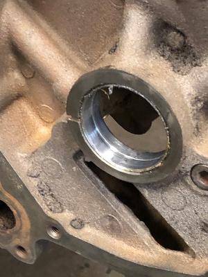

I wouldn't leave 'really bad' cam brgs in any engine. They won't get 'better', only worse.
View attachment 1305344View attachment 1305345View attachment 1305346
So long as that old cam is true it should work fine...
