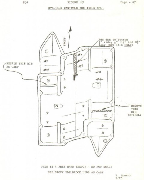

I had better luck with the low-deck STR15 (383-6/400-6) 4.15" stroker 479cid
still needed a bunch of lil' mods to make them work 100%

the manifold intake ports & it kind of kills the purpose of the cross ram
long runners effect, for the intended low end torque, getting you
in a heavy car, off the line quickly
I have a MP 383-400 6bbl intake currently, slightly modified, ports worked
AN -6 line, 1" phenolic spacers & I like the results, wow my drivers rats nest :poke:
both the STR-14 & 15 manifold in single dominator
or singe 1450 950cfm 3bbl square bore
perform absolutely great right out of the box, if you know how to tune a good carb,
like Holley, stager jet them after reading the plugs, make it right
(or todays Oxygen sensors & gauges aides)
still the appeal of the 6bbl is worth giving up a lil' at after 6,200 - more like 6,500+
unless you are running at wide open all the time
same deal with the stock 6bbl intakes, I prefer the Alum. versions
weight savings/heat distribution alone is worth the change
