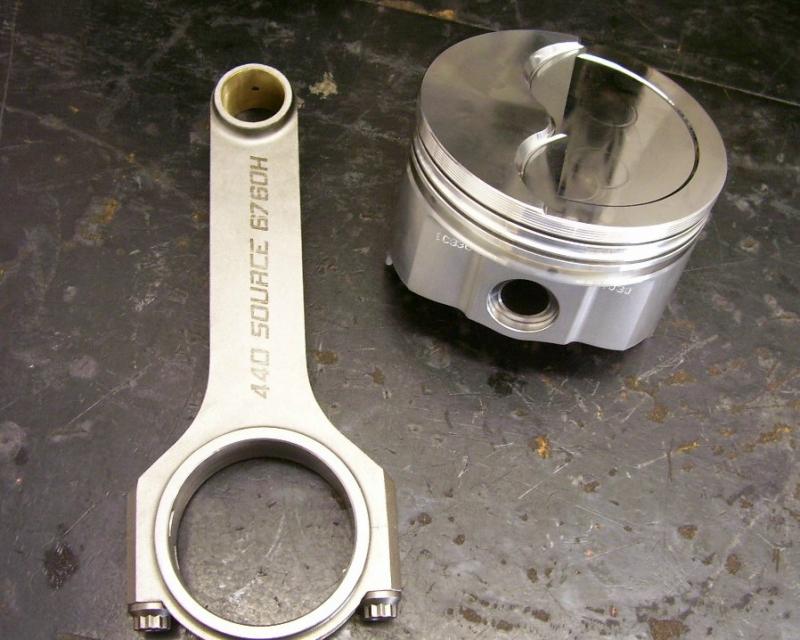

i'm using some Icon 836 pistons and 440 source h-beam rods with edelbrock 84cc heads. went together easy, very pump gas friendly, plus it takes about .75lb per cylinder off the reciprocating parts compared to stock.
